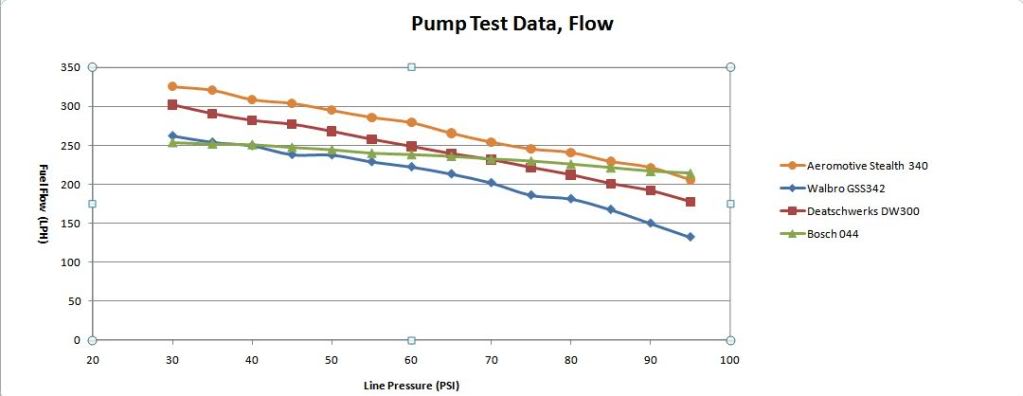

MetalMan: I put the Deatsch in my Allroad; GREAT pump (flow (better than 044), noise); was a BITCH to install (no 'ready to use' kit for my Allroad; not sure if they make one that fits the 1.8T AEB better).
Selected the pump based on flow comparison and power goal (Walbro NOT even close needed 600 cHP capacity, particularly at high pressure (think 43.5 psi nominal, add 30 psi boost = flow at 75 psi; may even want to run my EV14 at 5 psi, heard they are working even better at the higher pressure).

Mike, thanks for the input. If pressure holding with the Walbro becomes an issue, should be possible to put an inline check valve in (normally part of the pump itself).
044: no question, great pump and royal price.
IMO: no question that the Deatsch beats the 044 in the performance/price category.
