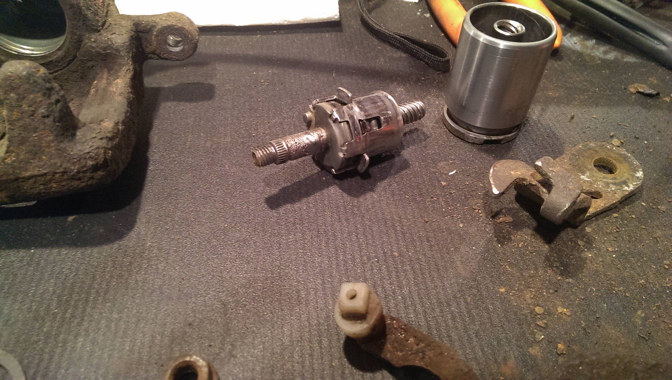

So everyone who knows anything about rebuilding calipers knows that rear calipers with an integrated parking brake mechanism are a huge PITA to rebuild. After reading many write-ups I decided to give it a shot.
Unlike any of the pictures I've seen online, I discovered that on my 2000 A4 the shaft, cap, spring, and washers are actually installed as a single unit. The cap has tabs that wrap around the alingment washer at the bottom (see pic). So if you are doing this and manage to get the retaining ring out (which is the hardest part by far), don't be surprised when the internals of the caliper don't just fall out. You need to unbolt and remove the bracket from the back of the caliper, and then carefully hammer the shaft in for everything to come out from the inside. I used a drift punch as to not damage the threads.

That looks a lot like the S4 calipers I started to rebuild (but ended up trashing due to stripped bleeder screw threads).

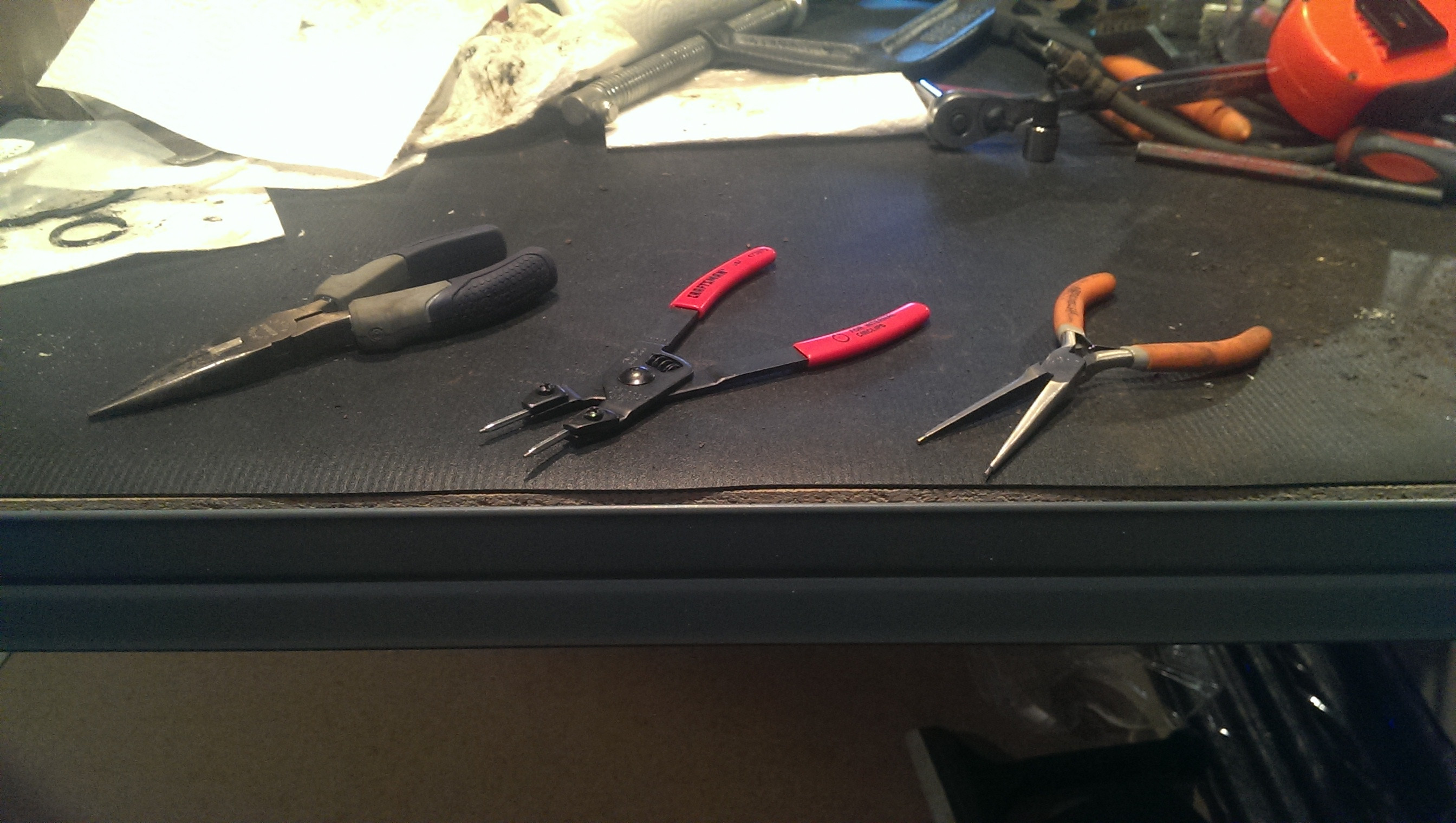

What did you use to get the retaining clip out? I used this:
Also, the assembly inside the piston comes out as well, with a similar retaining clip. If you buy a full rebuild kit it will come with a bunch of random O-rings, and one of them will go on a shaft where the assembly inside the piston meets the piston.

I saw that tool too and was going to buy it but first I decided to try this.Originally Posted by MetalMan

5-3/4" Needle Nose Pliers
Those pliers are TINY. I was able to file the ends into small points in a matter of seconds, honestly. Then I carefully bent the handles away from the joint. It is not a 90 degree bend like the Motion Pro tool, but its about 30 degrees which is enough to get the job done. Even with the integrated spring/cap unit, you still have to compress the spring slightly to get the retaining clip out and back in unfortunately.
And yes I replaced the o-ring in the piston as well. See my reply regarding the rebuild kits and how they are missing parts.
If anyone is curious, here is the tool I ended up using, shown next to standard needle nose pilers and retaining ring pliers for size comparison. You can see how the handles are bent, which allows clearance from the caliper to get down into the cylinder.
I don't really have a problem with buying $25 tools that I will very rarely use, I have tons of those. But since Harbor Freight is literally around the corner from my house, I have started to make modified tools in some situations if I can come up with an idea that might work.
