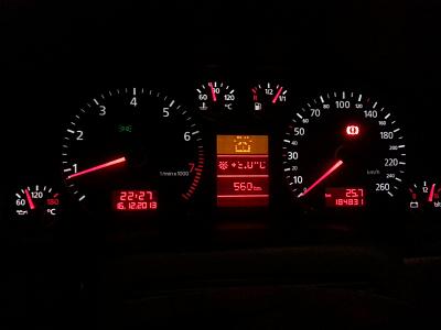

I'm going to try to post a picture I took of my instrument cluster. I had just come home from filling my gas tank when I took this picture, so you can see that even though the tank is full, and the engine is warm, the gauges are not reading correctly.

A very minor point, but is your instrument cluster displaying the date correctly as 16 December, or am I misreading it? You must be somewhere in very far east for that to be the case given the current time!!
What do you mean by earth connection? Do you mean grounding? If so, where should I begin looking?
I live in Canada, and it is most definitely December 16th today!

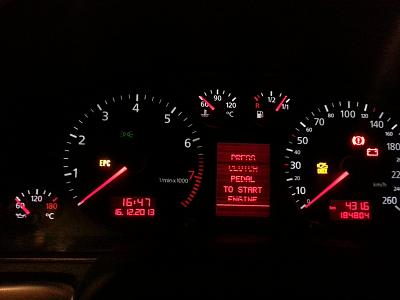

Ok, good news and bad news. The good news is, after driving it for nearly an hour tonight the oil and coolant temp gauges started working! So apparently the thermostat swap did fix those two problems. I also noticed that my car was running smoother, the heater was working better, and the 'miles to go' number increased from 520kms to 610 at one point! Looks like that will help my fuel economy as well.
Bad news: my fuel gauge still isn't working properly. You can see it's still not near the full mark, even though I only drove about 25kms.

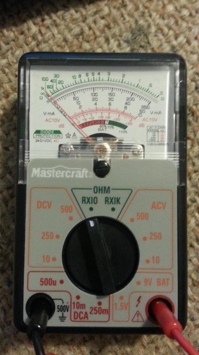

I'm posting a picture of my multimeter just to make sure I'm using it correctly. I read the 2nd row of numbers from the top (the black text).
The correct scale for ohm resistance is the top that is green.
