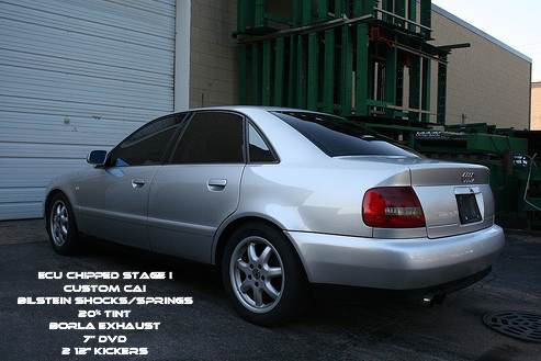

This one has my exact rims, same color and everything, but it looks lowered to me. He mentions Bilstein shocks and springs, but I don't know which ones.
that does look lowered. the springs i have drop 1.5" in the front and 1.2" in the rear. it makes the car handle nicer and look alot better but i can still get over all but the largest speed bumps, moderate pot holes, and some heavy snow in the winter without scraping. i dont mind the "slammed" look if the roads i drive on were 100% flat. but out here in the boonies, theres alot of ailing pavement to contend with.
