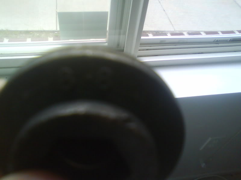

My bearing nut from my back left wheel snapped!
So i spent about an hour detailing my rims and tires using tire wet and rim polish/cleaner, and they looked great, this was at about 7pm. The next morning at 11:00am I came out and noticed that the center cap on my back left wheel had fallen off, upon putting it back in, I noticed that a large black bolt broken in the middle lay next to my tire. I then looked under the center cap again and noticed that the rest of the bolt was still stuck in. If i started driving, my wheel would have fallen off....
Since the time between the bolt being fine and the bolt being broken involved no driving, the only cause I can think of is someone tampering with the wheel or trying to steal my rims (which are stock, lol) I'm really not sure though.
I have never in my life heard of a bearing nut snapping. If anyone has heard of this happening please let me know.
Here are some pics (best i could do with my phone)
Piece broken off inside...
And the rest of the bolt...

Holy crap. Someone is trying to kill you..

ouch, good luck getting that bolt out of there. you might be better off buying a new axle. that bolt is pretty thick to have just snapped while parked like that.

looks like you'll need an axle too. that's crazy man. it's not that easy to break that bolt.

Good news, I ended up getting the bolt out of there. Basically I removed the rotor and bearing to get a good angle on the broken bolt. I used vise grips and it for some reason came out smoothly.
