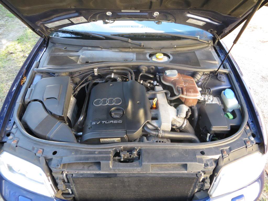

Looks pretty clean! First thing I'd do is flush the coolant and replace the expansion tank. That tank is supposed to be clear, and the coolant is supposed to be bright pink. Looks like the PO mixed G12 with regular coolant. It turns that nasty brown color and gets really thick. That can lead to over heating problems.

Sorry, should have been more clear. The brown colored tank in the first picture you posted should be clear, and the fluid in it should be pink. Like this:

Awesome. What's the pink coolant called? I rather ask for it by the name instead of the "pink" coolant hahaha

Its called.........G12 !!! it says it on the coolant resivor

Yep, it's called G12. You can get it from a number of places online, but it's one of those things that's just easier to get at a dealer. They always have **** tons of it and it's not any cheaper if you buy it online.
