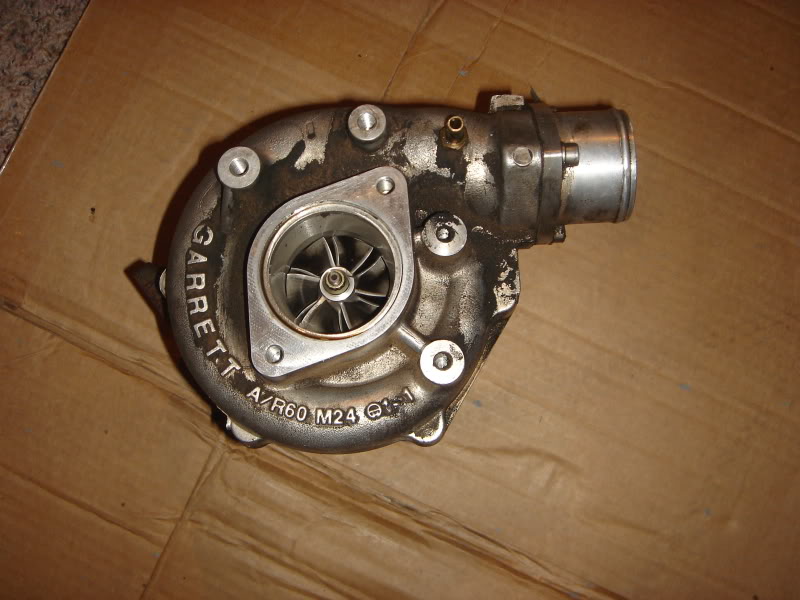

This part of the news was a double edged sword as it could have been worse ........ My seals on the turbo went bad so I called ATP in Hayward CA and they said that my turbo qualified for the Garret ball bearing replacement program. Basically I get a new gt28r turbo minus the housing for $420 plus shipping. The turbo is in the process of being removed and the turn around is one week. Just thought I would post up as I have not posted anything new in regards to the car in a while but she will be back on the road in full operating order soon followed by a new photo shoot of the completed project.

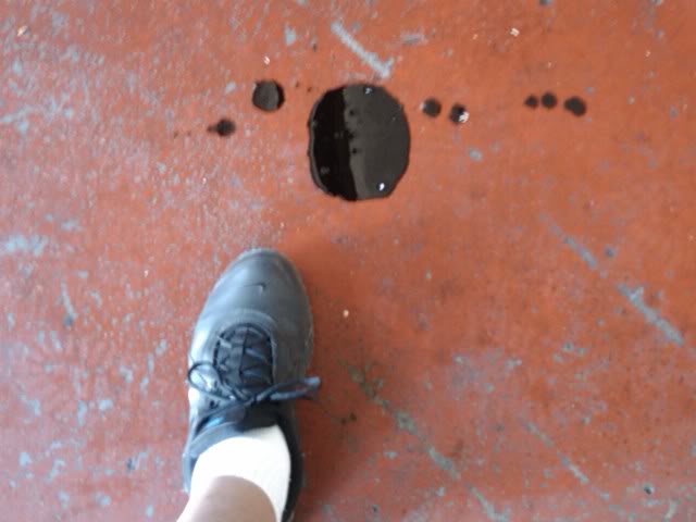

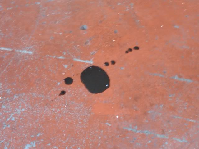

Here is what leaked out onto the shop floor when the car was started. The car still has good boost and it still feels good so hopefully it is just the seal but I will basically be getting a new turbo when all is said and done.

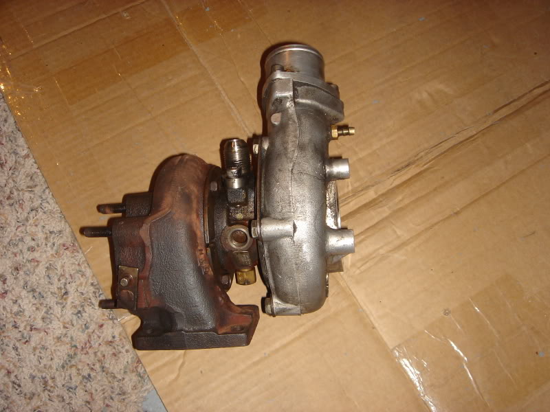

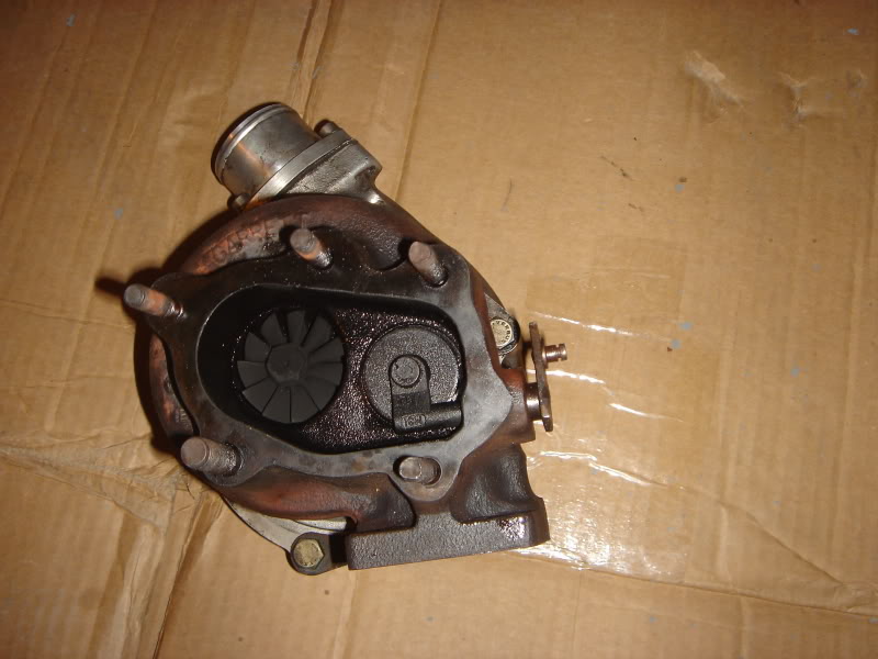

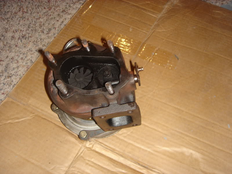

Here are some updated pictures of the removed turbo. It's boxed up now and going to ATP first thing in the morning, let me know what you think, but there is actually zero shaft play.

I called ATP today as they received the turbo on Monday. I guess people don't usually send in the entire turbo as they told me they were going to run a complete test on the entire turbo and not just the center section since i had sent the complete turbo in. If it qualifies for the replacement program they said I may get a new housing as well which would basically mean an entirely new turbo .......
Or if it does not then I will have to pay for the entire thing myself .........
I'll know by Friday either way .............. ???
