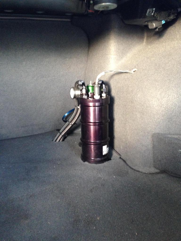

Originally Posted by BaseDrifter
Looks great! That's a slick surge tank.
Thanks man!

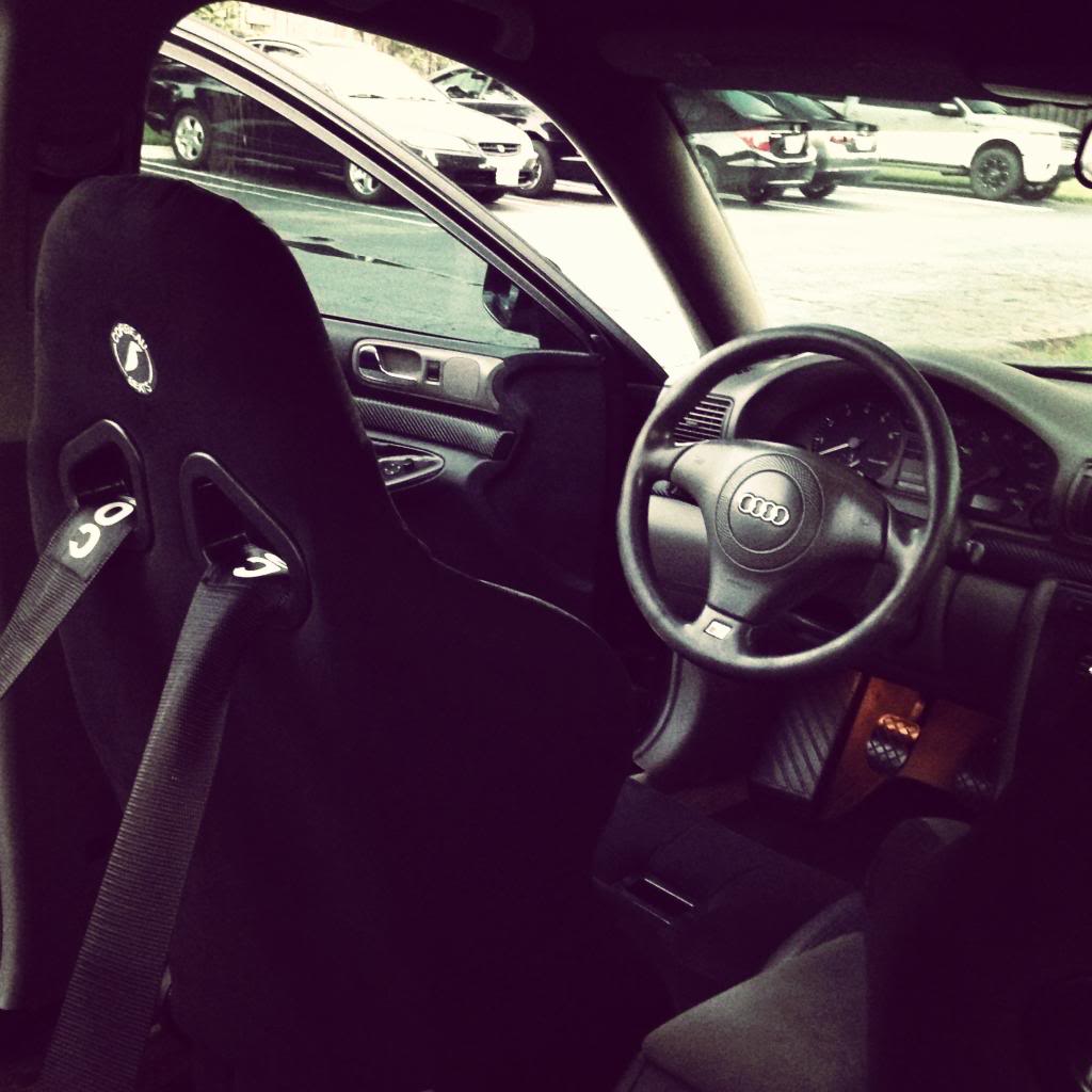

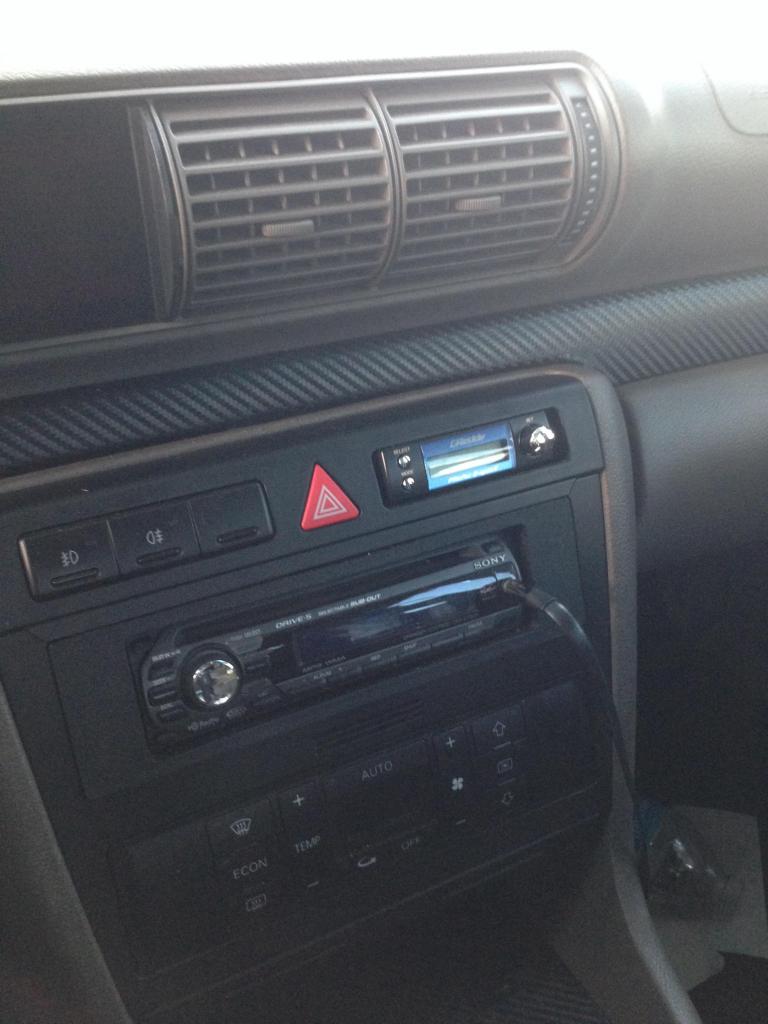

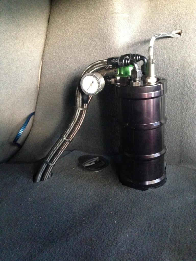

car is running, surge tank is in..Also a new Profec-B Boost Controller

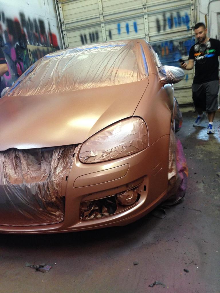

And here is a pic from work, after we finished a new color mixture to achieve a Copper Metallic here @DipYourCar.Com

I like how you took out the cupholder and the left a/c/heat vent. It looks nice. It looks reallllllllllllly nice.

Thank you man!! I really like how it turned out.

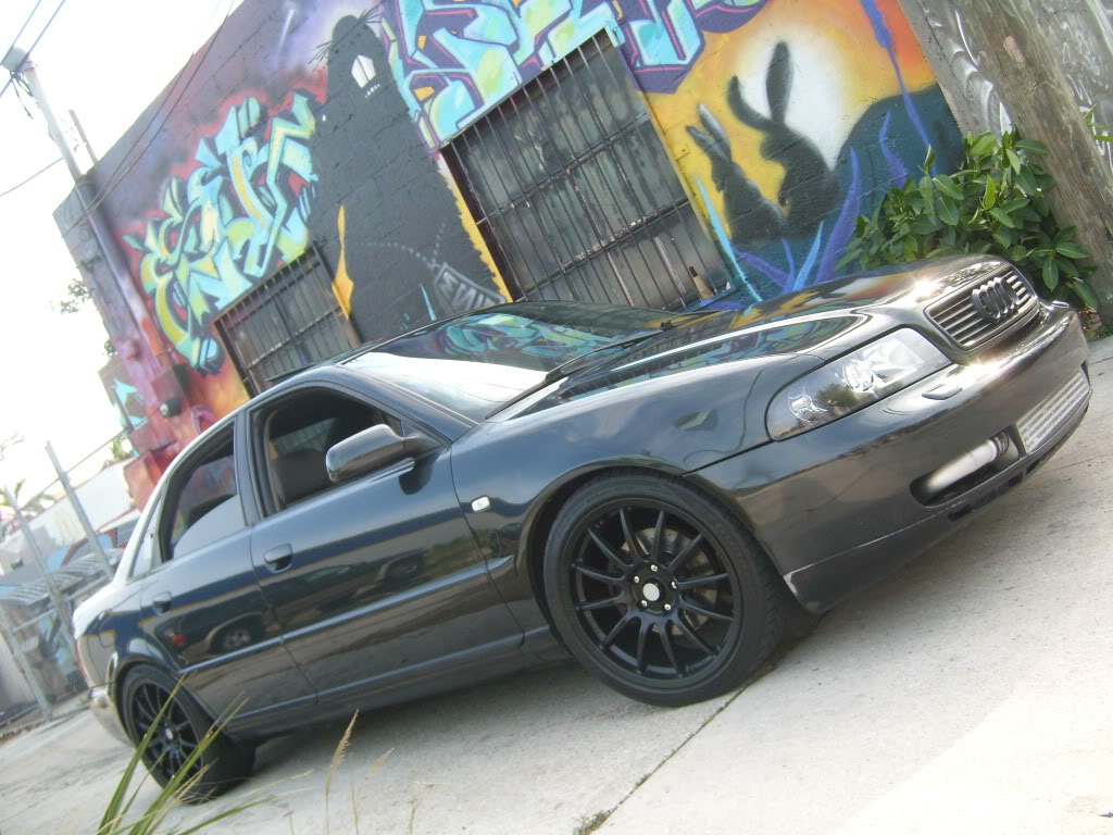

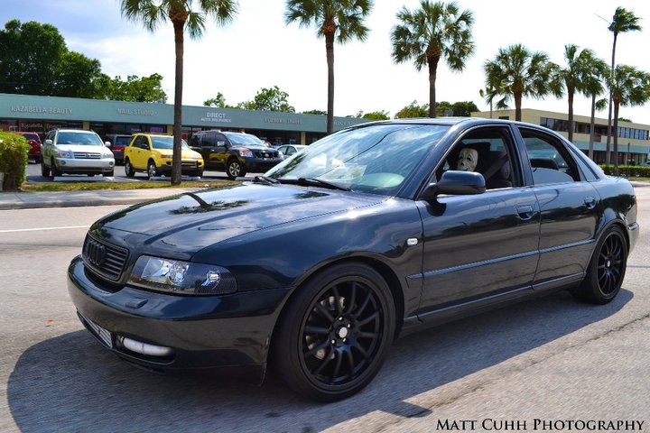

Tuning starts tomorrow! should be conservative power until I receive the new intake manifold in a few months. Estimated around 450-475hp
just so you dont get bored Here are some Pictures from over the last year =)
Enjoy

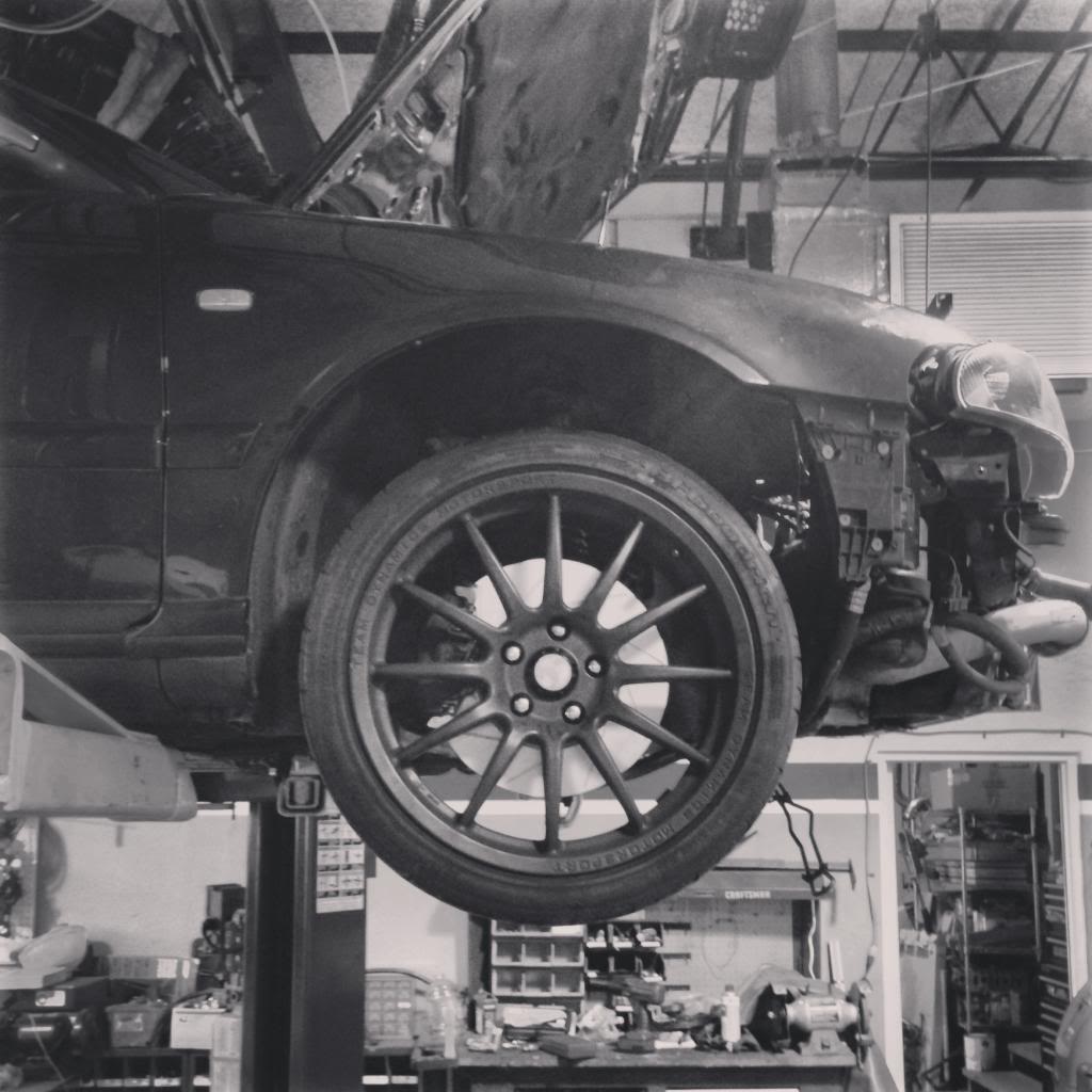

Those rims are pure sex. Time to upgrade those brakes though. You could definitely fit bigger rotors and calipers.

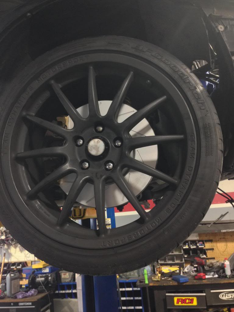

I need the brakes to clear my Stock Wheel for the Racing Slicks.....That pic was taken a year ago, I have the OEM BBK A8 Rotors and TT carriers now. went from a 288mm-312mm disc. I have to change out from the A8 to my Stock A4 Brakes when I go to the track and a StopTech Kit or AP Racing BBK are whole new calipers and would suck to change every time I went to the strip.

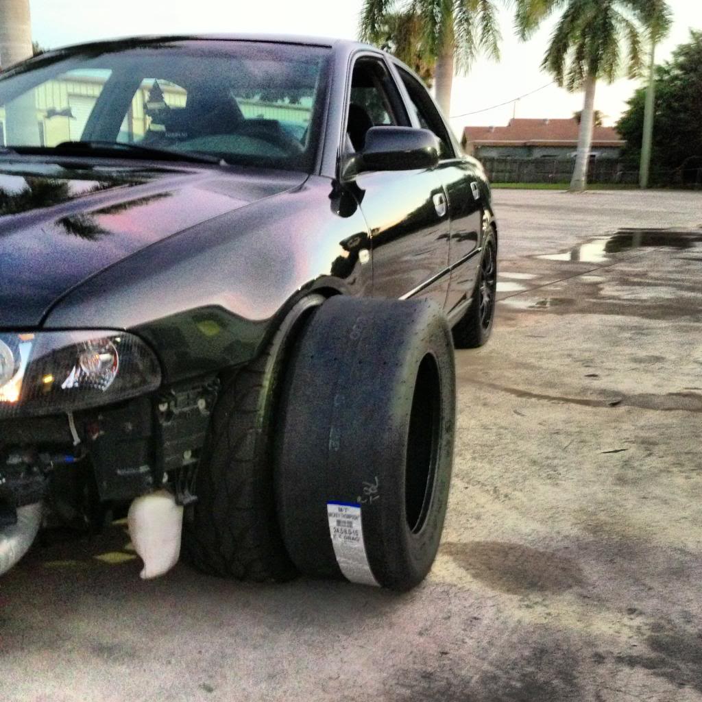

I run Team Dynamic Pro Race 1.3 wheels and they are 18lbs each 18x8. I love them but unfortunately I cannot fit a racing slick on them...
A racing slick is a special tire designed for Drag Racing...Because of my car and setup I can only run a slick the fits on a 15inch rim...
here are my slicks..

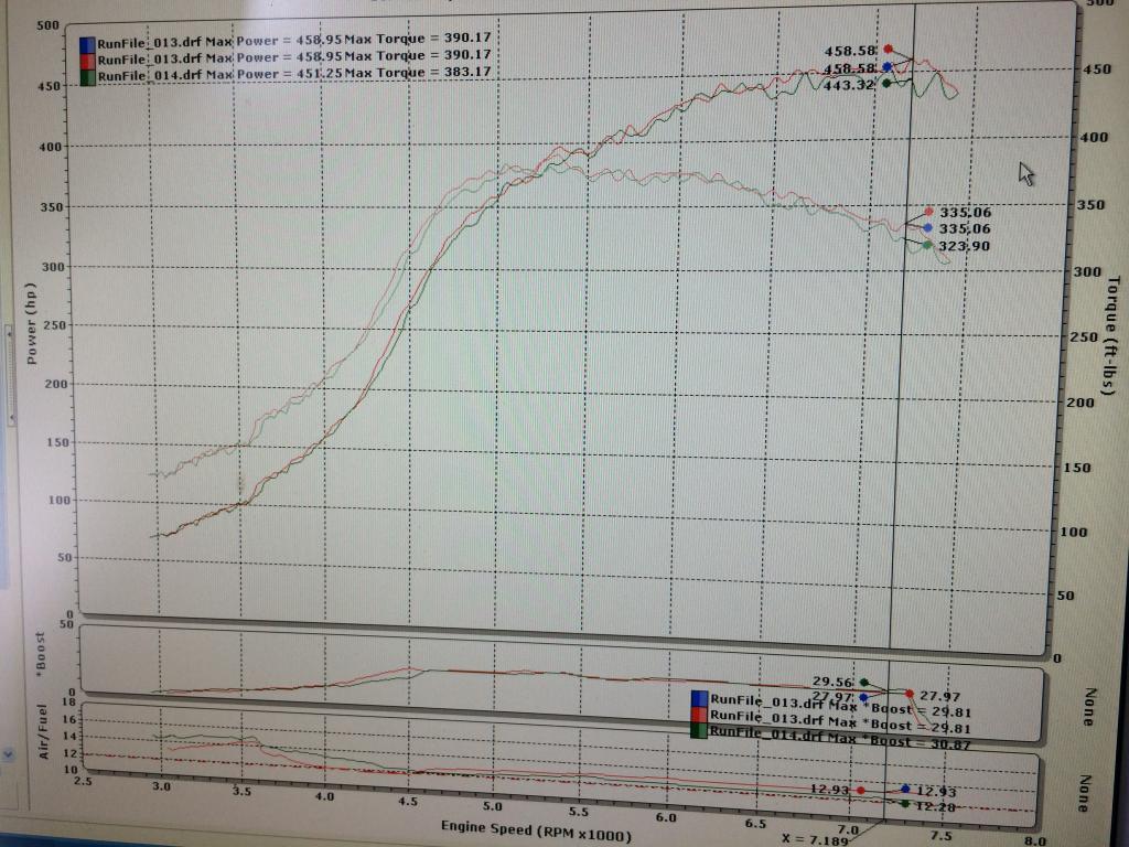

Threw the car on the dyno for tuning and we are keeping the car at ~460whp and ~390ftlb @~30psi until I can get the cams and intake mani in this summer(possibly the exhaust mani too)
