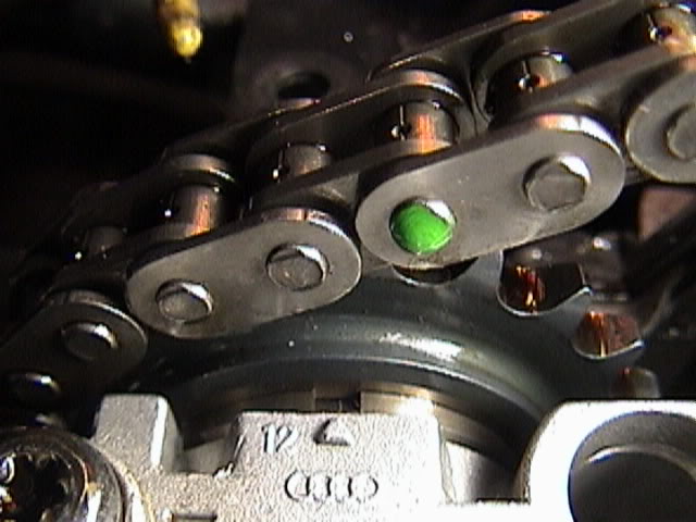

I have had this posted for several days and no one has chimmed in with an answer. Any help would be appriciated. Here are some pictures. I have 16 rollers from green dot to green dot. Timing belt is right on. Car runs rough. At idle I get misfire on all 4 cyls (VAG-COM), but at part throtle no misfire. I thought maybe the chain was off a cog, but I'm not sure. Experts, chime in.
">Name:  DSC01997.jpg
I am editing this post so anyone who does this job yourself needs to have the green dot 1 spot
to the left on the exhaust cam pictured below to be correct (see diagrahm a few posts down)
">Name:  DSC01998.jpg
The cause of all this. bought the car with 97,000 miles and had head and belt replaced 1,000 miles before that. It now has 114,000 miles. Why oh why would they put old style belt tensioner on?

Thanks, I'll do that. I just did a compression test and I have 160-165 across all 4 cyl.If I was working on one of my old V8s I would suspecta vacume leak. I didn't find one, but may have to check again.

you sure you lined the chain up right when you did it? It looks by the pictures that it is one tooth off on the exaust side? That would cause your problems. It may even throw the check engine light pointing to the HAL effect sensor (Cam sensor).
I am leaning toward your thinking. The question is do you start counting slightly to the left of the exhaust cam key-way or to the right of it. If you are to start the 16 count slightly to the left, then you are correct. I don't want to just go switching teeth untill an expert advises me to do so. Like I stated above I still have good compression (160) so I havn't hurt the $870 head yet. No big hurry to get this done so I can wait till I can doo it right (I feel lucky that I havn't hurt anything yet).

you wont hurt anything if the chain is 1 tooth off. the car will just run like ****. you are to start the count slightly to the left of the exaust side.
