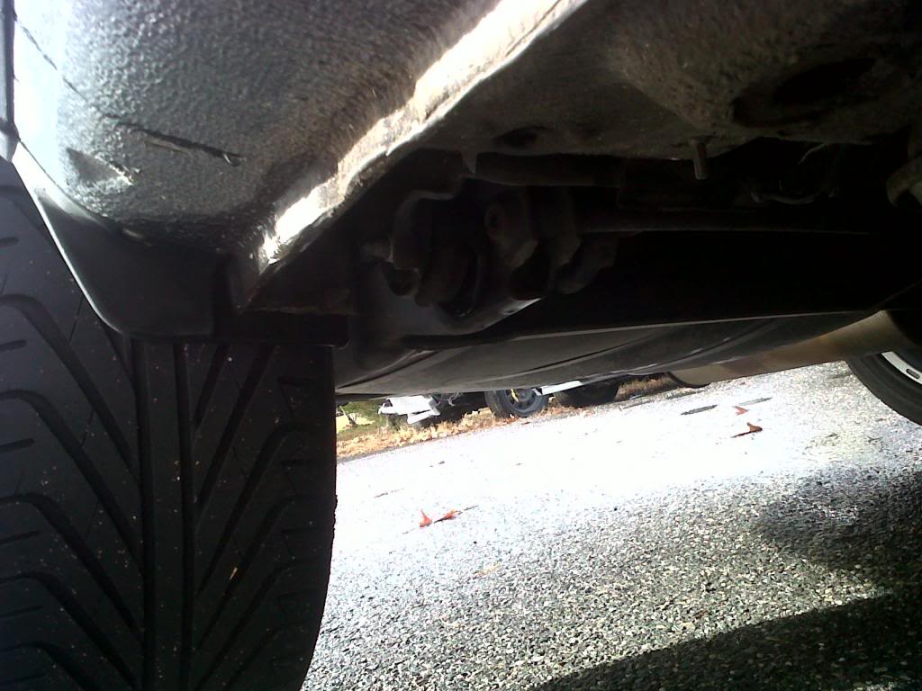

The rear end of my car feels like its walking around on me left to right. I see which bushing is broken on the right rear right infront of the tire. i just am completely lost as to what its called and need to know what to order. maybe a lateral link? im pretty sure its not the subframe bushing. Its moving a lot and i want to get something a lot more solid any recomendations?

can you back the picture up so we can see the area its in and not just the bushing. Take a pic of the rear of the car and circle the bushing location.
thats the view of the passenger side looking towards the rear of the car

Is this a front wheel drive car?

yes fwd car

Nobody has a clue to what its called? I have looked for hours and cant find the technical term so i can orde one

Yep, confirming my own post here. Has to be the rear axle beam guide.
http://www.autohausaz.com/search/pro...FQoTbAod6APOEA
