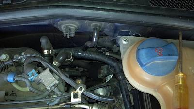

ok big update, i went up and looked at my SAP, it is bad, the upper hose is missing( i am guessing that it was attached to my factory intake) i unplugged it to see if it will stop the whining upon startup. here is a pic just for referance,
NOW. there is a second whining noise, that is present after the car has warmed up and never goes away, yes it sounds like a supercharger almost, goes up and down with RPM's, this noise is not related to the SAP, it almost sounds like it is coming from the top, front of the engine... near the coils or intake manifold, maybe just below them. i will update a video tonight, the sound is very clear in it i am just having trouble getting it from my phone, to here.

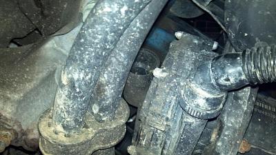

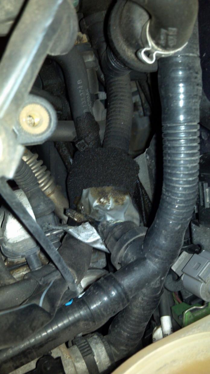

also i found this while i was looking at the vac lines, i dont know if it is related, but it looks like someone put some kind of sealant on this line and covered it up with duct tape

SAI is only used on cold starts it wouldn't stay on and cause whining. A tensioner would be a good place to check.
