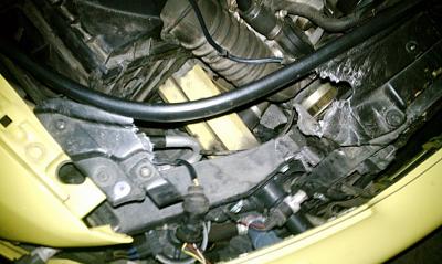

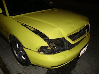

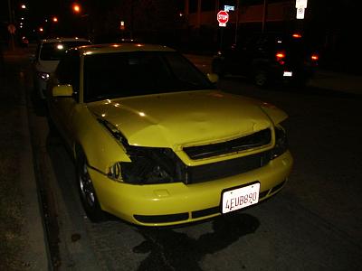

So yesterday I ran in to a stake bed truck…we all know how that ended. The passenger side took most the damage, doesn’t have any frame damage. What I need to know are radiator supports interchangeable 1.8=V6? Pre-facelift = facelift?

They are not interchangeable. When I replaced my radiator support for my A4 2.8L I went through great lengths trying to find the correct one. The 1.8L support lacks certain holes to route hoses and cables and what not and the facelift is not compatible with the non facelift as the headlight mounts are different and lacks certain holes, etc... The most frustrating part was that some vendors claimed a certain support was compatible with facelift 2.8L and it wasn't. I ended up calling Shokan and paying them $205.20 shipped for used radiator support. The part came in and it looked brand new, not a single scratch nor grease. I could eat off that support and most importantly, it was the correct radiator support. Good luck!
