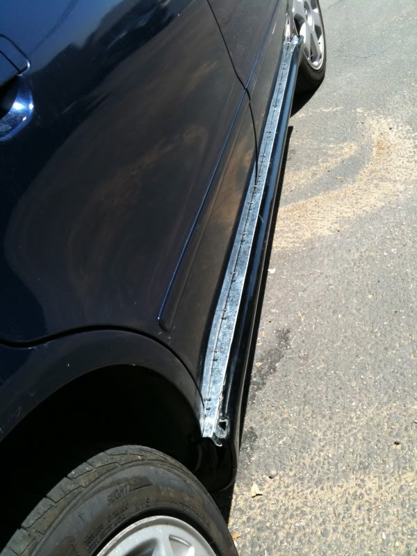

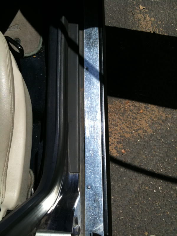

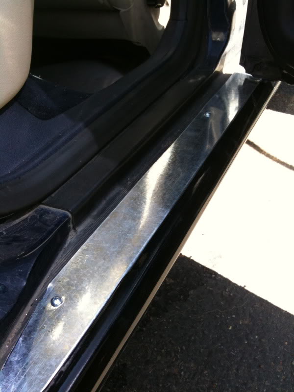

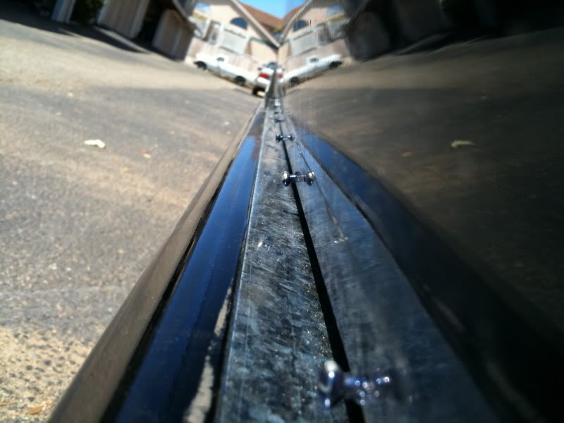

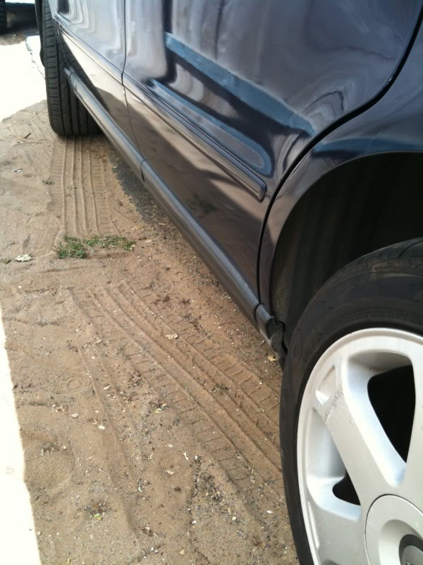

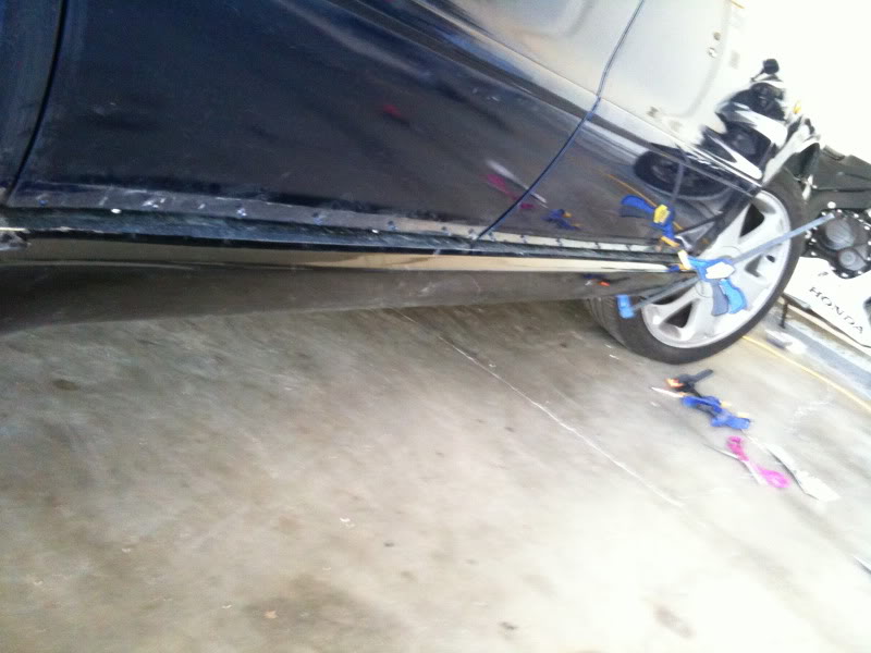

So i'm about to start my widebody and i got my sideskirts from my buddy's S4 but once installed they just looked a little too stock. The OEM rs4 skirts are wider than the s4's and look great so i decided to just modify my rocker panels. I found a few 10ft lengths of angled sheet metal and cut them to fit my stock rocker exactly. I ripped off the lower door moldings and grinded down the clip mounts smooth. then i just attached the s4 skirts to that for about an added inch. These are rough stages of the job but i will most likely blend the seam and clean things up a bit. i'll post more pics as things progress.

lil question. are you going to do something with the doors? or are the side skirts going to be sticking out? i cant really visualize how this is going to work :P
It's hard to explain but if you take a look at the widebody RS4 you'll see the way the front and rear fenders blend into the "wider" sideskirts. I'll post a picture of one if i find it and you'll kinda get the main goal i'm shooting for.

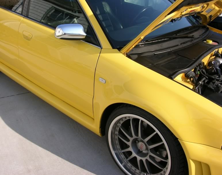

here you go, this is look i want to achieve:
