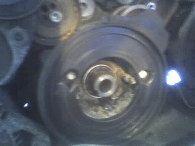

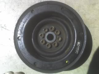

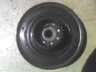

Which notch is it on the pulley? I don't have any of the timing belt covers, they were all busted up in an accident, and I just pulled them all off and threw out. Unless its this plastic disc here. Here's front and back of the pulley too, theres a round notch on the back side, and yellow painted one on the front, they dont line up together. Thanks for the help! Its very much appreciated.

WTF? How did you get the crank pulley off? That toothed gear is not supposed to come off the crank shaft!
If you don't have the lower timing belt cover i think your screwed until you buy another one. See that cut out on the left side of that round plastic cover? Thats where the arrow usually points to the notch on the crank pulley. Un-less there is a notch on the top left of that round cover.

Thats what I said when it came off. Loudly. I took out the screws first, but the pulley wouldnt budge. I couldnt tell what was what. So I took the crank bolt off and boing! I figured the gear was held on the crank by more than a puny 1/8 inch long keyway.
I found the arrow on the plastic cover. Which mark do I line it up with on the pulley? Do I have to separate the cog from the pulley?

There is an etch on the back of the crank pulley that almost touches the arrow, you may have to clean it to see it. I would just leave the cog on the crank pulley, or you can seperate it, it really doesn't matter.
But the cog is what i wanted you to use white out on, that way you can mark a tooth on it and the block to know if the crank shaft rotated when you do the belt.
