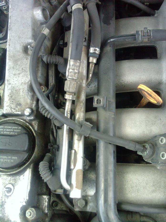

Now I'm focusing on the clogged injector possibility and trying to swap the injectors around like randomaudiguy suggests, then taking it for a rescan to see if the misfire moves to a different cylinder. You have to bear with me here, I used to wrench on my own cars a lot when I was younger, but its been a while, I've never worked on an Audi before and I didn't bring many of my tools with me when I moved out-of-state recently. I'm attaching a pic of what I assume is the part I need to remove to get at the injectors. If you look at the pic, I'm assuming that the long, shiny metal tube in the middle of the pic, that looks like it feeds fuel to the injectors, needs to be removed first. It has 2 hex bolts near either end, I was going to loosen those to lift up the tube to get at the actual injectors to swap them-correct? Is there anything else special that I need to do in there to get at and remove the injectors?

Yes, the injectors are on the fuel rail. Undo the electrical connections on each, unscrew the 2 screws, and the whole thing pops out with all the injectors still attached to the rail. I've never actually swapped injectors before, so I'm not exactly sure how the injector comes out of the fuel rail.

I ran out of time to work on the car today (and daylight, I don't have a lighted garage to work in either) so here's my plan for tomorrow: I'm going to try removing the fuel rail like you said and taking the whole thing out, it sounds like it comes out in one piece. Then hopefully I can figure out how to disconnect and swap the injector from misfiring cylinder #3 with another one and see if the misfire moves to that cylinder. If that's the case, I'm still not quite sure where to go from there as far as unclogging the injector. I found one write-up that talked about soaking the injector in some injector cleaner.

I'd advise replacing the injector. You can do the seafoam just to try it, but if you find a faulty injector i would replace it. After you get the rail out, just pull the injector out, the rail sandwiches it to the block. Take care with the O-rings.

I took out the injector rail and pulled the injectors off from cylinders #1 and #3 (#3 was the one that was misfiring) when I looked at the injectors, I saw that on #3, there's like a plastic ring around the bottom of the injector, the end that actually sprays the gas. On #3, this ring had cracked and part of it was gone. I don't know how this could have happened, but something's definitely not right. #1 looked fine. I swapped them and went back to the parts store, but someone else was using the scanner. I asked the guy to look up and see if they had an injector in stock, they didn't and have to order them, it would take until Thursday to get it. So, now I'm going to look on the net and see what I can order and just for kicks, I guess I'll call the stealership tomorrow and see if they have one and what crazy price they charge for one.
