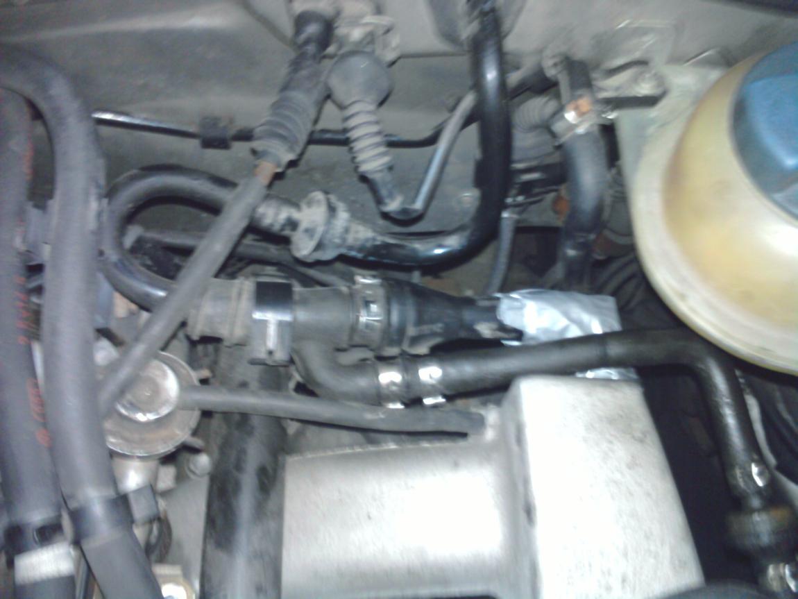

Default Cracked vacuum elbow next to what looks like the suction pump
I had a guy who knows Audis that I found on craigslist come over and take a look. He found a cracked elbow sucking air and its right next to what looks like the suction pump people were talking about here. Since its a stealership part, I duct taped it for now till I can go to the stealership and have them rip me off for a new one. Car is ideling fine now and misfire is gone, but then it comes and goes anyway, so we'll see. His other idea is the ignition control module, but I'm waiting to see if the misfire comes back first before I order one on Monday.
In the pic, what I believe is the suction pump is the cone shaped thing in the middle and the elbow is the part to the right, now wrapped in duct tape!
