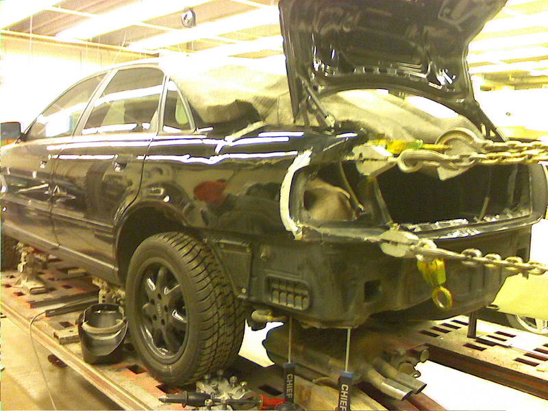

got some pics. got the trunk lid to fit today. and pulled the quarter out some more. pics.....oh and only the best tools lol

was your frame not bent? a corner hit like that usually bends the frame which can be a major bear even after it looks fixed. look at space between pillar and door on both sides of car and see if it's the same. Maybe you already addressed this. If so, please ignore. Good luck with the fix. Kudos on doing it yourself!
