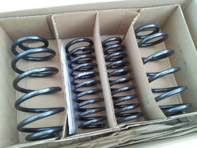

So i decided to spend a lil on lowering springs just to kinda get a feel of what its like to lower my car and stiffen the suspension a little bit. So i decided to go with the Eibach lowering springs (got em from amazon). the eibachs drop 1.4 in the front and 1.3 in the back.. took me about 3 hours to install em at the shop where i work and just wanted to share with the audi community just in case some of you guys are considering getting it.
my reviews on it are that it handles pretty good actually... you can feel a difference when taking turns now... i run stock 16" wheels and they do rub a little bit but its okay becasue they rub on the plastic cover on the inside of your wheel well and it'll just shave it off no worries (trust me ). the drop in my opinion is just perfect... not too high but not too low... it sits just right and the wheel gap is even... but this is not the end.. im planning on getting ST coilovers and what not... tell me what you guys think and if u have any questions/ comments. thanks!!
-Fish
These are the springs

Looks much improved! I've been thinking about springs for my car and what to do. I don't want to go as aggressive as coilovers. I'm currently running S4 springs and struts, which brought me down a little, but mostly firmed everything up. What is your ground to fender height front and rear with these springs?

I wouldn't consider my S4 setup stiff by any means. The spring rates are only 350 lbs/in front and 290 lbs/in rear. I can't seem to find any published spring rates for the Eibach coils you installed. Was there anything in the packaging that indicated what the spring rates were?
A finger is rather subjective, so I was wondering what the actual measured height was. It doesn't sound like these are much lower than the S4 springs I have now.

i didnt actually notice any spring rates... did you try eibachs website?

hey Fish just an FYI your probably going to experience premature strut failure. Its generally a good idea to get aftermarket struts vs just putting stiffer spring on stock struts, as the stock struts were not designed to handle the stiffer springs. Just something to watch out for. I have also seen your headlights before on a guys car, IMO they are probably the best aftermarket headlight they make thats not a Depo/E-code, much better than the halos people run. I kind like them actually
