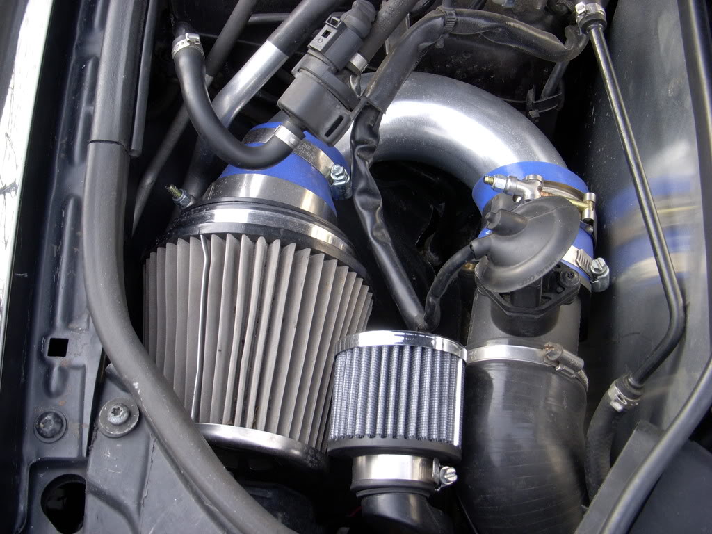

just finished installing this. i know a lot of people dont like bov on our cars but i cant resist the sound.
i was thinking this was going to be a lot louder from what ive read but its not...
IMG00421-20091006-1551.jpg?t=1254860838
IMG00423-20091006-1608.jpg?t=1254860914

The BOV releases air from the sytem and can create air/fuel ratio problems. I would consider getting a DV.
The stock airbox works fine for most setups. If you want to mess with it, a cone filter with custom heat shield is probably your best bet. There are a bunch of DIYs out there to help you.

correct me if im wrong but from what ive read thats only with 99 or older models, the map sensor in the 00 and 01 adjusts this problem after a day or two.
and yeah i was going to do a basic cone filter setup with a blinktek heatshield like this one...

You can use a BOV if it's before the MAF (not MAP!) sensor. That would mean a MAF relocation.

MAP is not used to calculate the amount of air the engine's getting (unless in speed density mode i.e. MAFless). The MAF and IAT together are used for that. The sensor that will save his *** is his front O2 sensor adjusting the mixture. He needs to relocate his MAF if he wants to correctly use a BOV, but you're certainly right in that he doesn't HAVE to.

where exactly would i need to relocate my maf sensor too?
