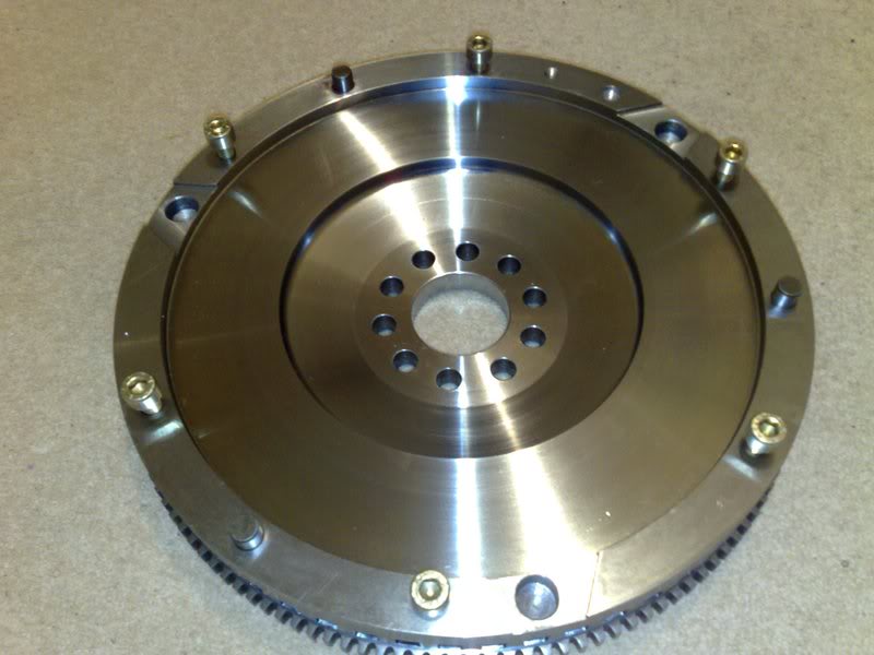

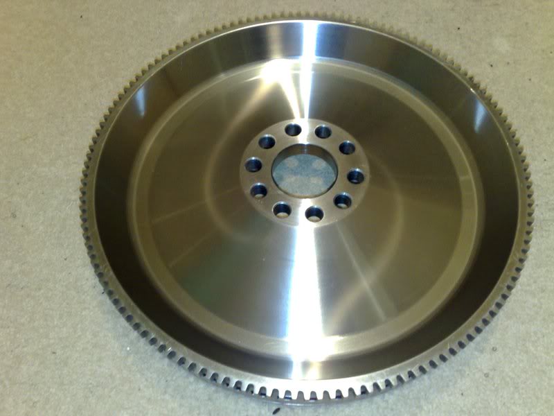

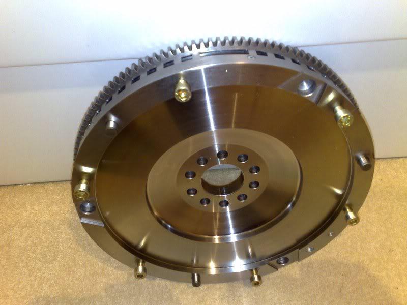

A lighter flywheel will not increase power.
However, it will make the engine rev more freely, less rotating mass means the maximum safe revs is increased.
I am not a fan of aluminium flywheels, and have removed these from customers cars, never fitted any.
Aluminium and steel have different expansion qualities, and there is a tendency for the steel friction surface to warp.
In one of the most extreme cases I've come accross, the friction surface was so badly warped, some of the retaining rivets were dragged out of the aluminium.
I supply lightweight steel items, for 1.8T, 2.7T, as well as all other V6 and V8 models, for both 4 and 5V engines.
This is the one going into my S8-engined B5 quattro...
