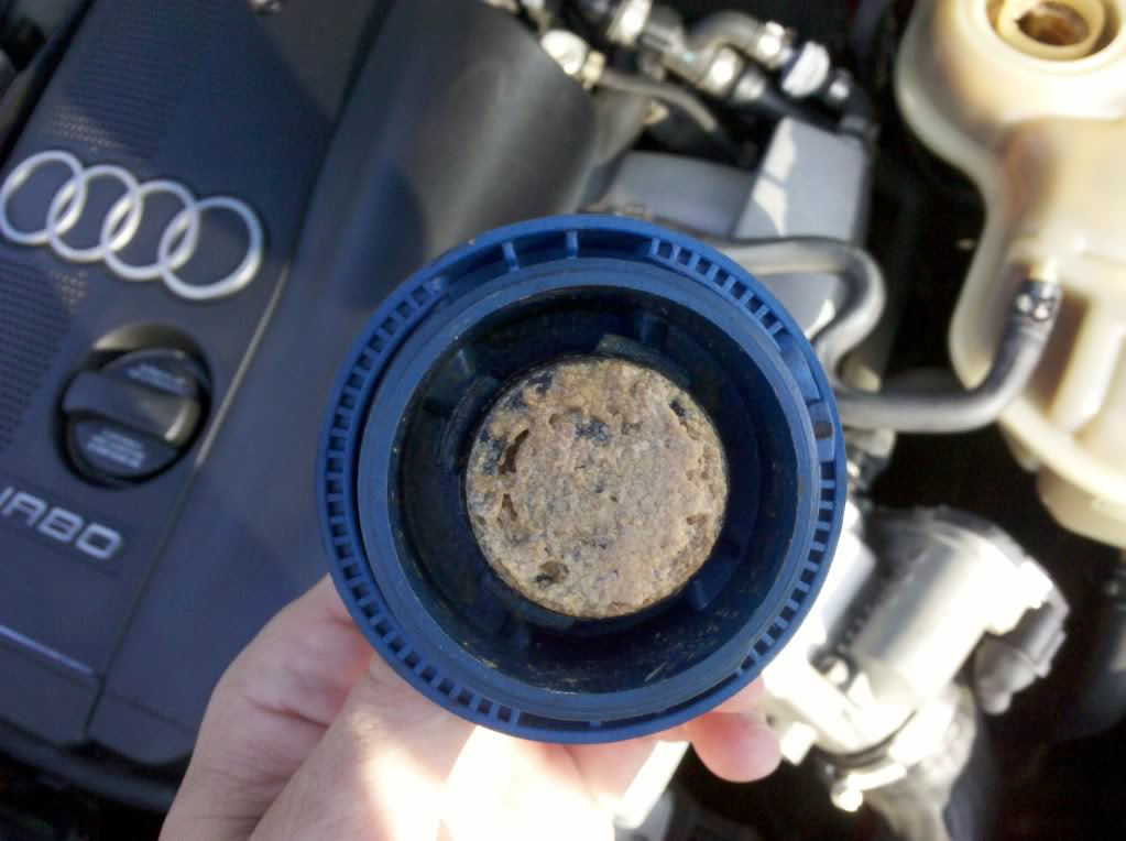

The sludge problem has been well-known and well-documented for quite some time. I wouldn't let that steer you away from a 1.8T by any means. The sludge really only becomes an issue if you run the small filter and conventional oil, or don't change your oil often enough. That said, its unfortunate that there are many A4's out there whose previous owners did both of these things. The reason there is a class action lawsuit about it now is that the small filter and longer suggested oil change interval were recommended by Audi, and there's no reason your motor should frag itself from following manufacturer's recommended maintenance intervals

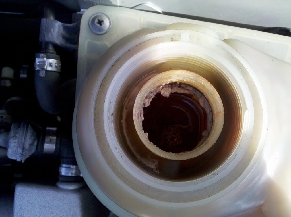

You just need to be picky about the car you buy. Ask for maintenance receipts, a carfax report, and any other documentation you can get your hands on. When you test drive it, tell the person selling it to STFU so you can listen to the motor. If it sounds like a diesel, or if you hear a lot of lifter noise or howling from the turbo, stay away. Pop the hood and take off the oil cap. If there is sludge, it likes to collect in the little nooks on the underside of the cap. Also take a close look at the coolant tank. Another common cause of problems in these cars is people mixing regular 50/50 coolant with the G12 thats supposed to be in there. It's normal for the tank to be yellowed, after all its plastic and more than a decade old. If someone mixed coolant it should be pretty obvious:
Just take your time, be very picky and thorough, and you'll be able to find yourself a nice, well-cared-for car.
