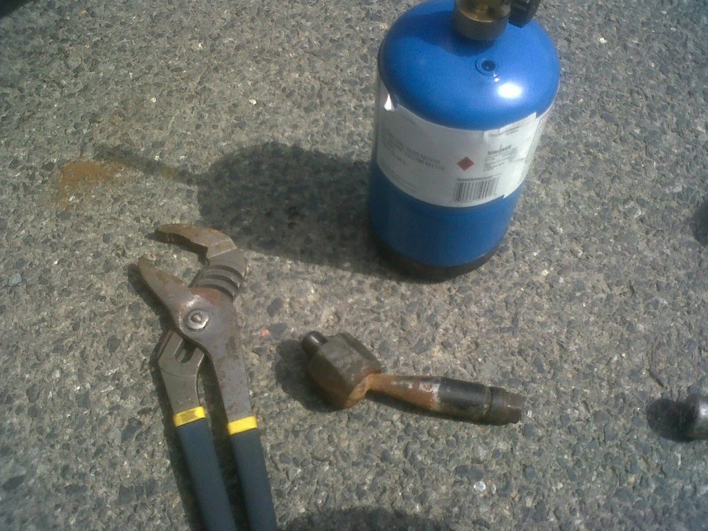

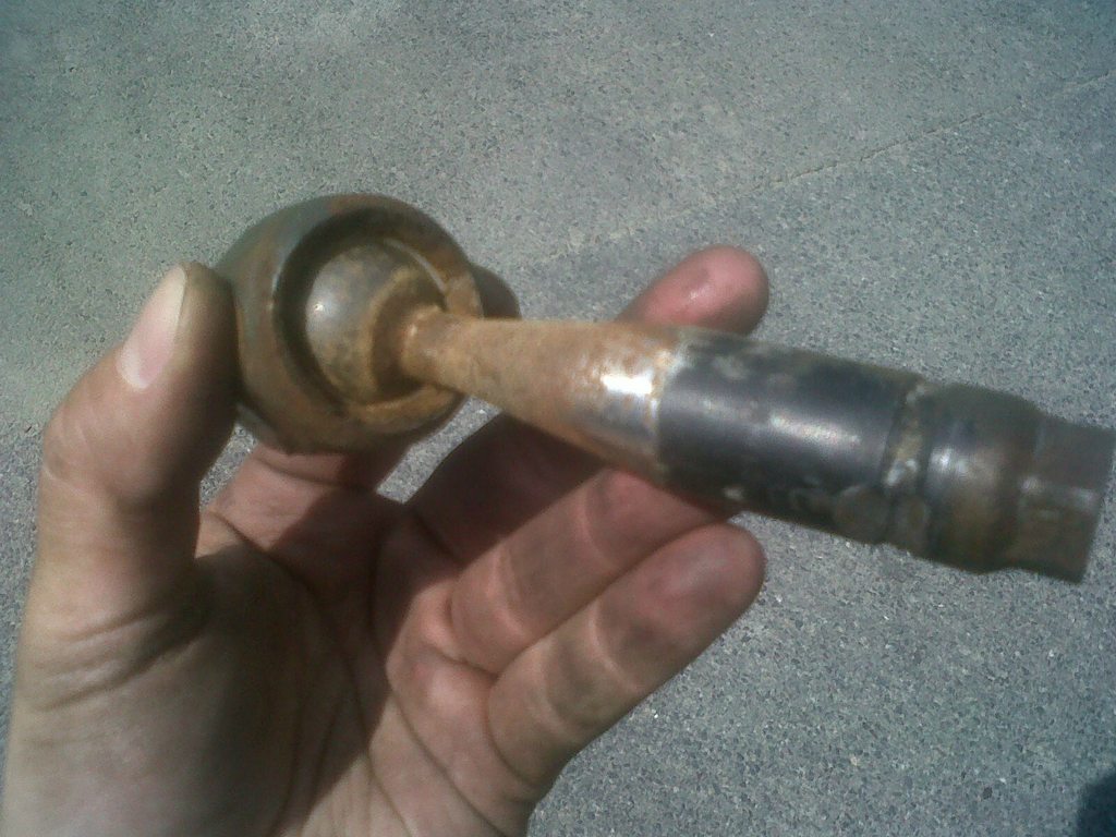

So as suspected the creaking noise was indeed the drive side inner tie rod. I didnt have the right tool but with a torch and some plumber style tool I got it off pretty easily.
The culprit:
