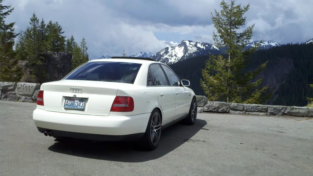

I would also recommend the Tein springs, but only if you have a 2.8. The S-tech (~2" lower) are only made for the 2.8 and S4 B5's and you don't want to run them on the 1.8 cars because you will end up raising the front. I'm running the S-tech springs with S4 struts (spring rate and valving match better) and love it.
