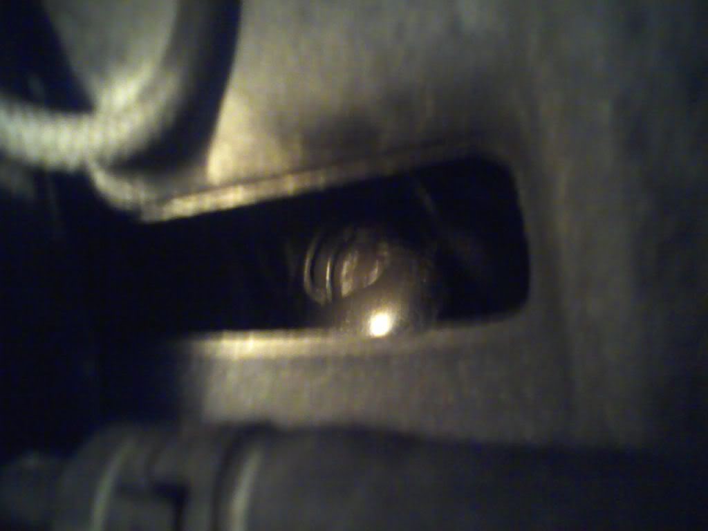

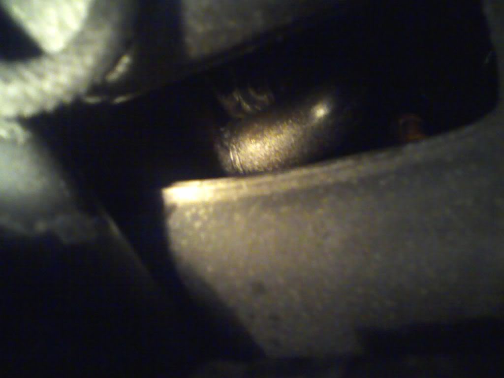

mines orange but the tube that is broken is black ill try and get a picture not sure how well itll come out

Ok, that help greatly. You broke part of your pcv system. You need to head over to ecstuning.com and locate the part you need to replace it. You can either order it from them or head to the dealer if you need it now.

ahhh awesome mate the bottome of it looks sorta like the ratiator hose clips were u press them in and it locks it
