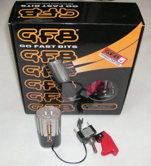

Originally Posted by kayakman13
In response to Mike, do you have a link to this setup? This sounds perfect for me. Could I just get this valve at a plumbing store or home depot? Or does it need to be a beefy automotive grade? Finally, I'd like to put it in the car for on the fly switching; possible?
Yes you could. It just needs to be any type of valve that you can turn open or closed, pretty much just like a water valve. it would be harder tyring to find one you can control from the driver seat since it would need to be electic and work off of a 12 volt source.
They do offer dual MBC's that allow you to control it while driving the car, its basicly just like a EBC but you manually set the 2 boost levels.
Problem is they are not cheap at $220-$250.
Turbosmart also makes a dual MBC that goes for $190.
Oh and I found this one from GFB for $107. http://www.ecrater.com/product.php?pid=1601258
