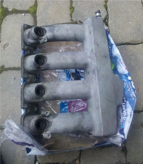

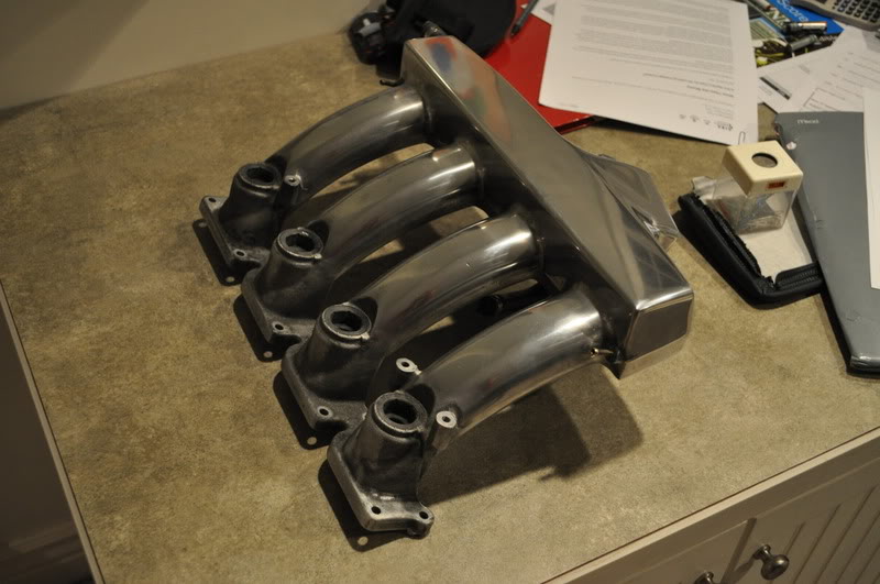

Welllllll my intake manifold is FINALLY done. If you're not OCD or completely **** this shouldn't take too long but mine probably took about 12-14 hours total....
I started out washing it off with some degreaser then used the following order grits 80, 120, 240, 400, 600, 800, 1000, 1500, 2000 (this was the final order, I skipped 1000 and 1500 the first time and it didnt shine just right) then I was annoyed by all the little scratches the 2000 left for you to see so I did some searching and came across Tripoli which is essentially a metal buffing compound and it worked amazing. After the Tripoli i used mothers mag and aluminum polish and buffed it off with a dreml and polishing pads and heres the finally result
Before:
After:
Before:
After:
