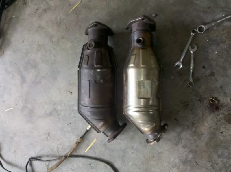

VMR Testpipe compared to the normal cat

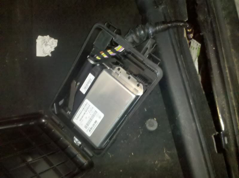

The hidden TCU (for sale)

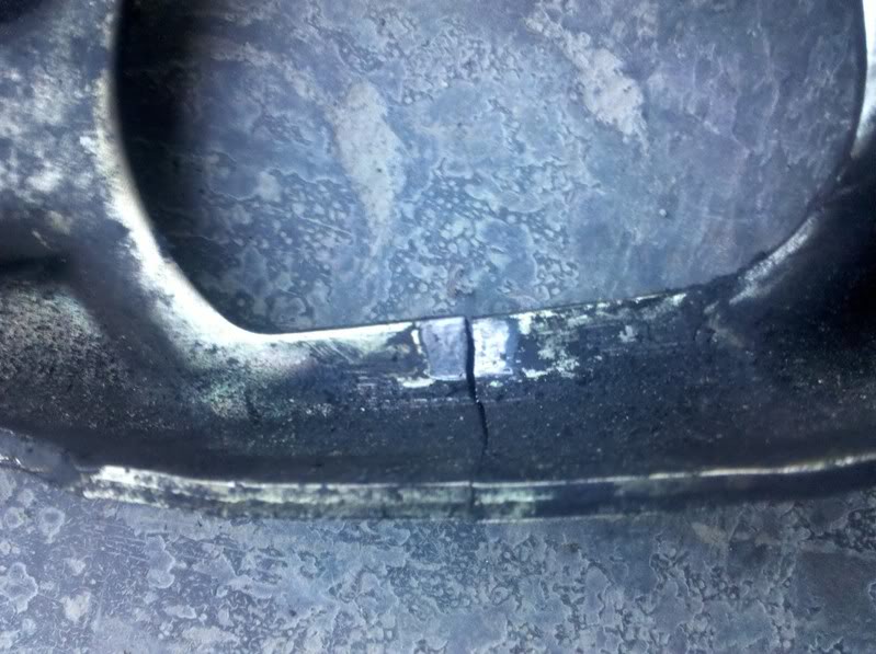

Cracked Clutch fork (more on this later)

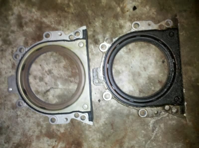

Old vs New rear main seal

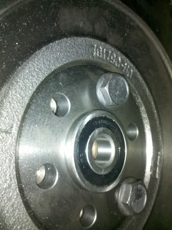

Adapted pilot bearing

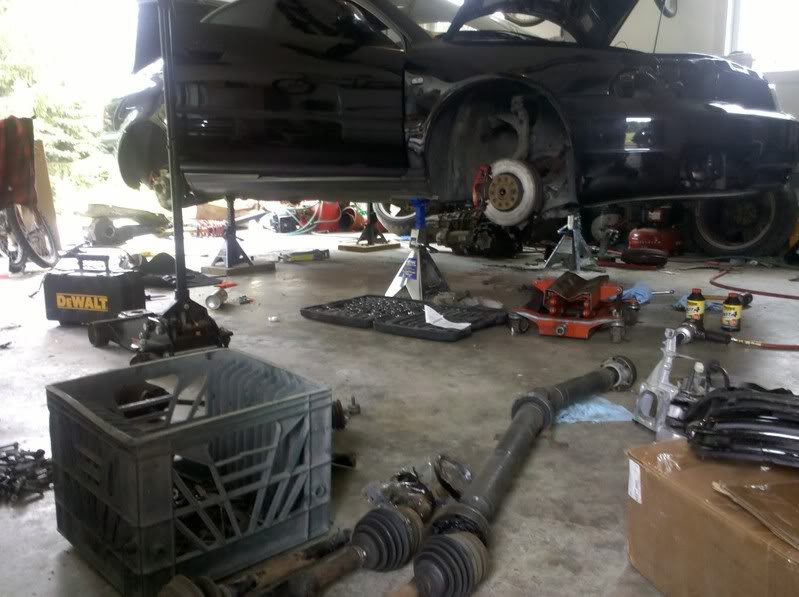

And finally... the carnage

4. CHECK ALL YOUR USED PARTS before putting starting the swap. I found out that the brake rod bolt and bolt retainer on my manual pedals was gone so I needed to swap that over from my auto brake pedal. When putting on my new throw out bearing I found that my clutch fork was cracked right where the bearing attaches, I found out that this part sucks to try and find. Luckily though my neighbor is very good with a welder and the fork looks brand new.

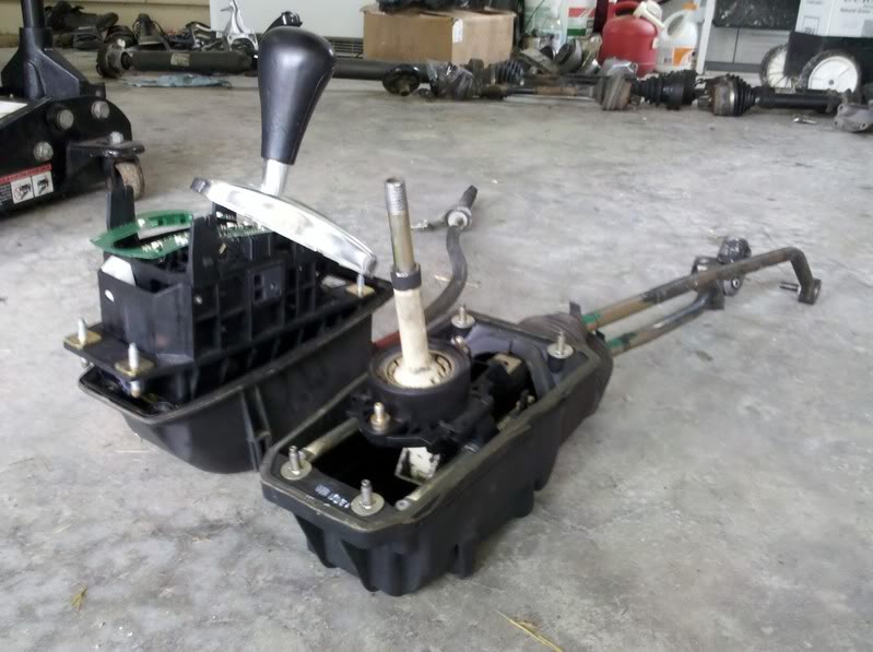

When getting out the shift box I initially tried to keep everything exactly how it was, for possible resale purposes mainly. But if you cut your losses here you'll save a TON of time and frustration. Im not even sure how its possible to get it out without breaking at least one of the plastic pieces and once I gave up on trying not to brake anything it really wasnt hard to remove.

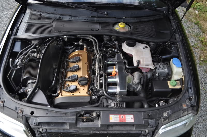

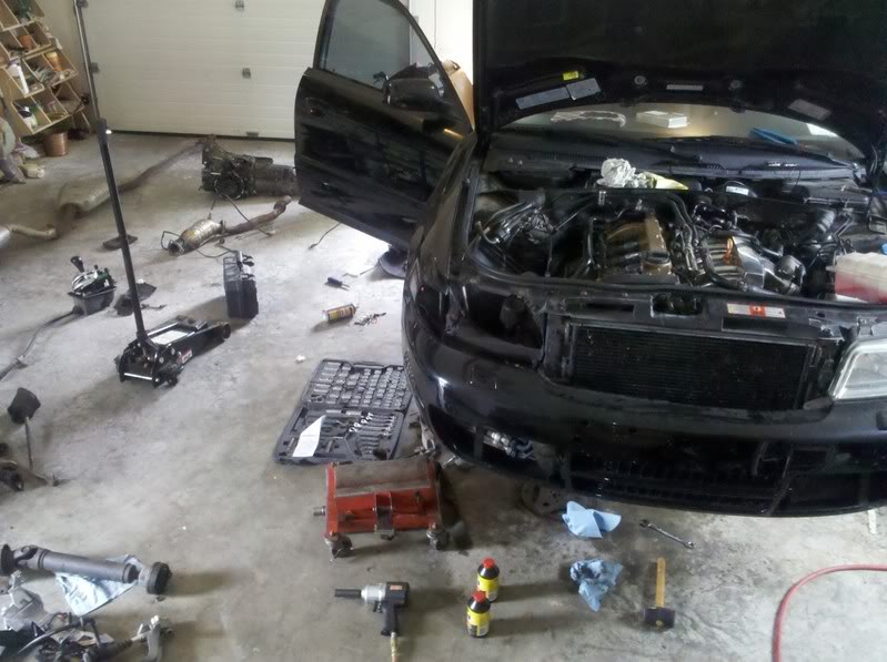

And I've been lacking on pictures so heres one of my engine bay, not finished with it yet but its a lot different than the direction I was going before.
