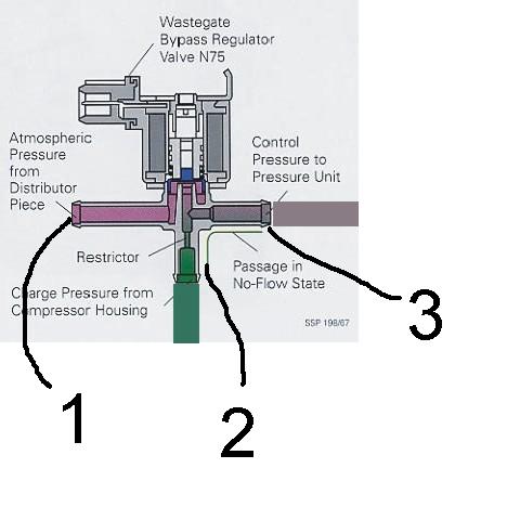

OK guys i found something out! check it out the picture u see with the boost control valve i have # 1 on the turbo intake hose but i put # 2 on # 3 so basically flip them and now my car does not stall jerk shake etc no check engine light but the power is like weak like i got no turbo lol.
correct me if am wrong but #1 goes to turbo intel pipe #2 goes to compressor housing and #3 goes to waste gate correct? if so that's how i had it and car jerks like crazy at WOT and when i switch 2 and 3 the car wont jerk misfire or anything but i get no power at all. wtf? 0_o
