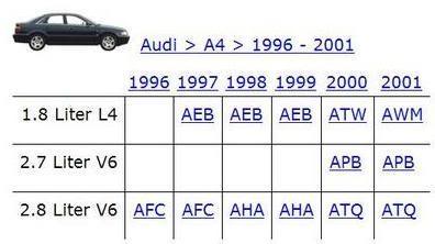

Thanks for the responses. I looked on the passengers head, and it is stamped AHA, so I am off on the year, maybe a 98 then. So far all I have noticed in differences is the engine harness, and possibly the throttle body. Im still trying to remove the tb from the new motor so I can look at it close up.

THe list above shows the AHA is used on both the 98 and 99.
