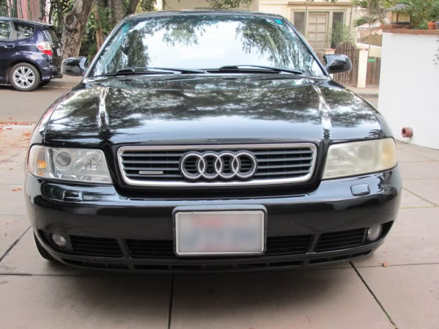

sup guys i just recently became involve in the audi/euro culture, witch i must say is way different from the honda scene not just in cars but in personalities. but enough of me on to the caro !
car info
1999.5 quattro 5spd with 130,xxx K
exterior is about 8/10 reason why minor scratches and clear coat fade on roof
interior 7/10 tear on driver seat on the bottom half, front driver and pass pillars sagging fabric same with the rear left,right pillars, head liner also sagging.
engine: fully stock has a leak on one of the power steering hoses and also is leaking anti freeze from the area where the oil filter goes, pls chime in this problems guys, also car is in limp mode and does not have any cell codes or check engine light, and temp gauge works when it wants or might be getting a bad signal from the temp censor. help me guys

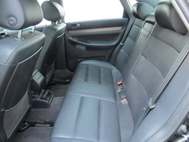

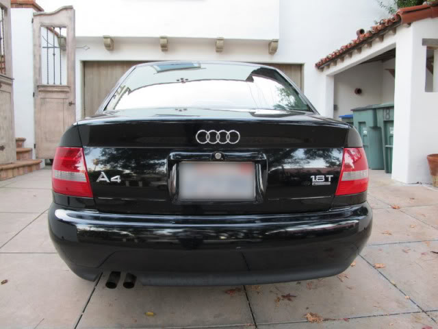

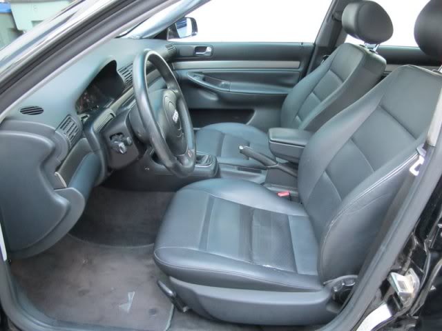

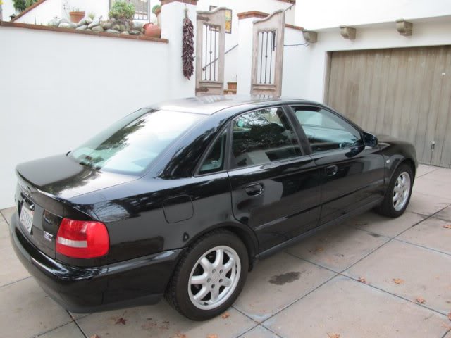

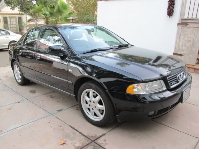

pics of the first day the old owner dropped the car off to me

Make sure to dig up your radio code before disconnecting the battery. Since you still have the stock unit in there, it'll need a car-specific code for you to be able to listen to the radio after disconnecting the battery. The code *should* be in your owner's manual, if its not, well hopefully someone else chimes in on here that knows where to pull it from; I think its physically written on the back of the radio, which is a pain to get to, but I could be wrong so anyone else that can shed better light, please do
As for the car, she looks good man, can't wait to see the build progress. Also, maybe it was just the picture, but it looks like you could use a headlight lens restore kit?

car looks good. and it does look like the drivers side headlight needs to cleared up. I have the same boost gauge. and i love it. very easy install as well. im a little upset with Podi though, they sent you more stickers. i only got the all black one
