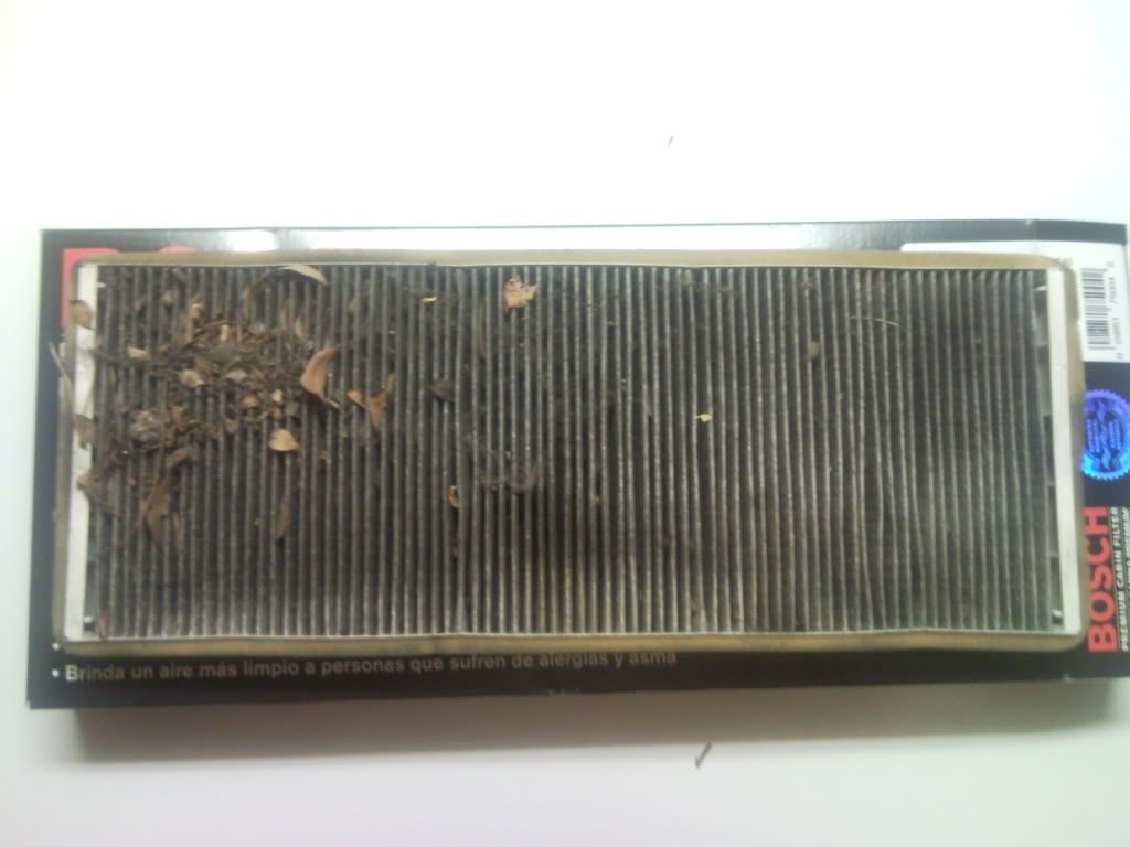

+1 on the cabin air filter, I changed mine about a month ago, and the **** was so nasty i'm not sure it had ever been changed.
