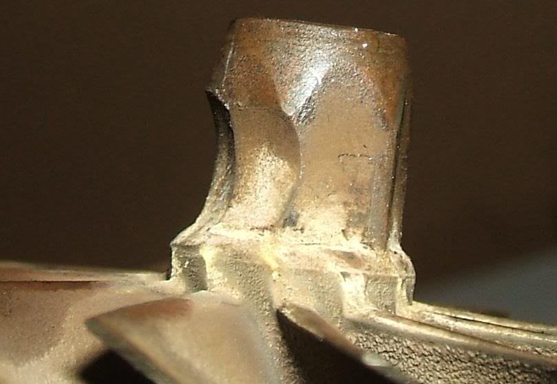

The tip of one of the compressor wheel blades is chipped. How much would this affect the balance or performance of the turbo?

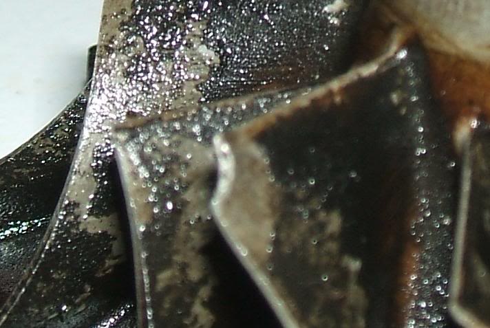

Failry large chunk taken out of the end of the turbine end of the shaft. I'm assuming this was done intentionally for balancing?

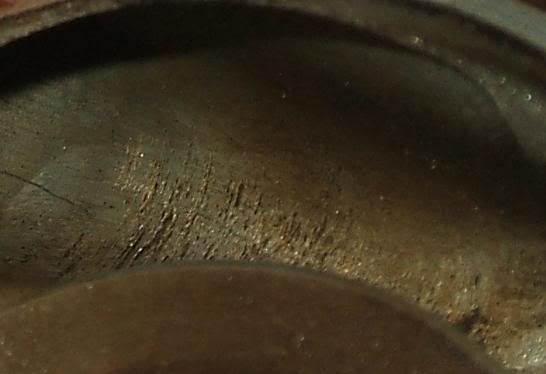

Some slight scoring of the inside of the compressor housing (probably from some very small debris). Is it worth my time to sand/polish all this out? I know replacement is probably unnecessary.

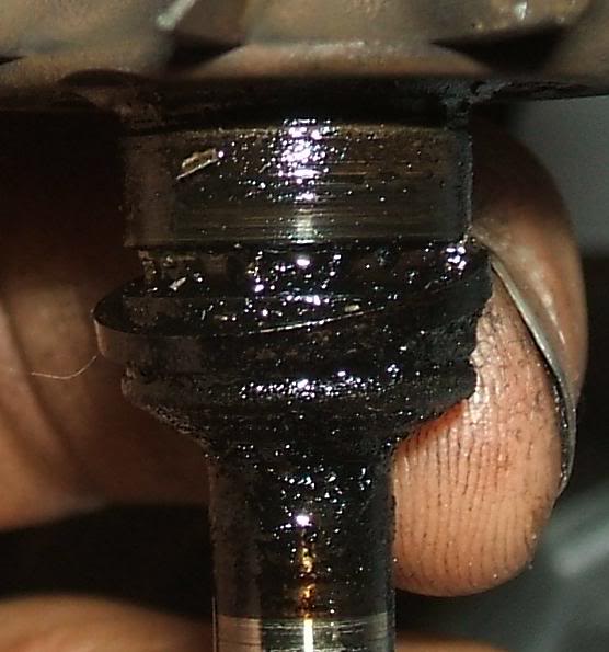

This ring was completely out of it's groove and covered in sludgy oil. Is this the reason I've had dirty coolant for the past few years? I know the ring gets replaced, but I'm hoping the shaft won't need to be.

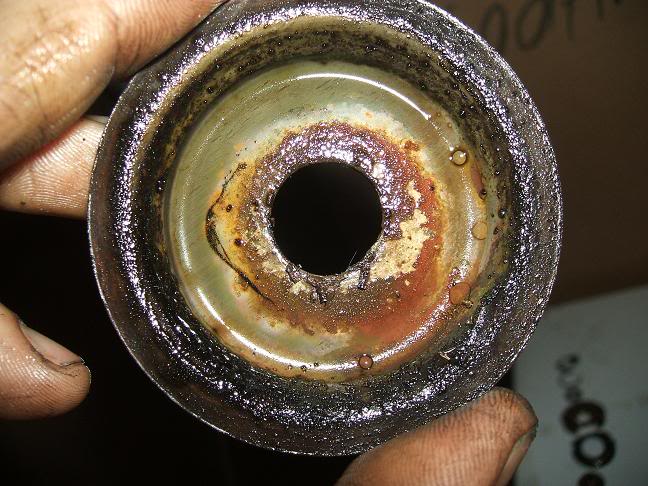

Sludgy oil and sludgy coolant caked onto another part. I know this doesn't need to be replaced, it's just dirty

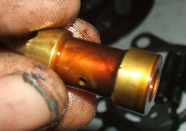

Sludgy coolant. Rebuild kit came with a new one of these, so it's getting replaced.

If the blades made contact with the housing, you need a new wheel and to have it balanced. Also, most used turbos are about $150 on vortex.
