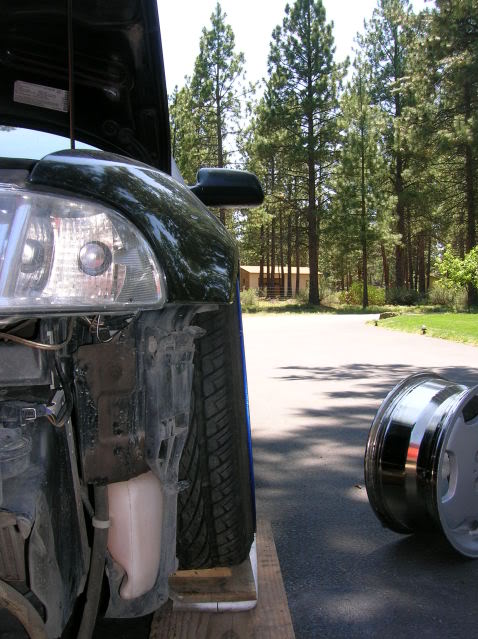

Well unless I can find 5mm adapters nope! We measured out 20mm the smallest we have found (*other than krip who just called me @ 15mm) but this is what 20mm on a ET33 will look like! So yeah NO LOL!
So if anyone wants some 5x100s lemme know!!!

Nice poke!
You can pull it off with some negative camber.

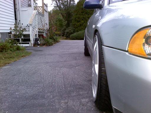

you sure you measured out 20mm correctly...? I know of at least two different guys who ran 8.5" wide wheels, one with et18 and the other with et21 and neither were really poking, pretty much flush though. 8" et13 should be pretty much the same shouldn't it? (with one piece wheels) .5" wider would bring it farther out .25" which is ~6mm, correct?
here's 8.5" et21

I think you should recheck that poke.... have you considered redrilling?

yea i had though that seemed alittle much on the poke but i assumed he was doing good measuring lol

What's the width of the second picture (black B5)?
If it's 8.5, I don't think he's running ET 18. I know that 8.5 with ET 25 is pretty much flushed for B5 (not poking). So if the second B5 is running 8.5 wide with ET 18, he should be poking a lot more.
