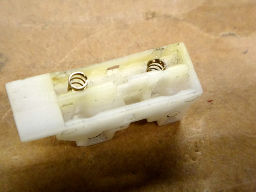

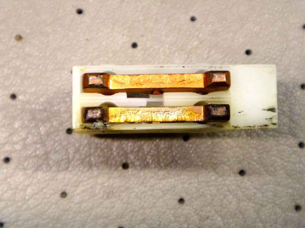

Both my headlights and my fog lights went out the other day. I assumed it had to do with the switch, did some searching, and found the solution.
I've pulled the steering wheel off so many times now it doesn't take but a few minutes. I also found a way to skip a few unnecessary steps I was doing before.
Here you can see where the headlight switch contact was not being pushed up fully into position.

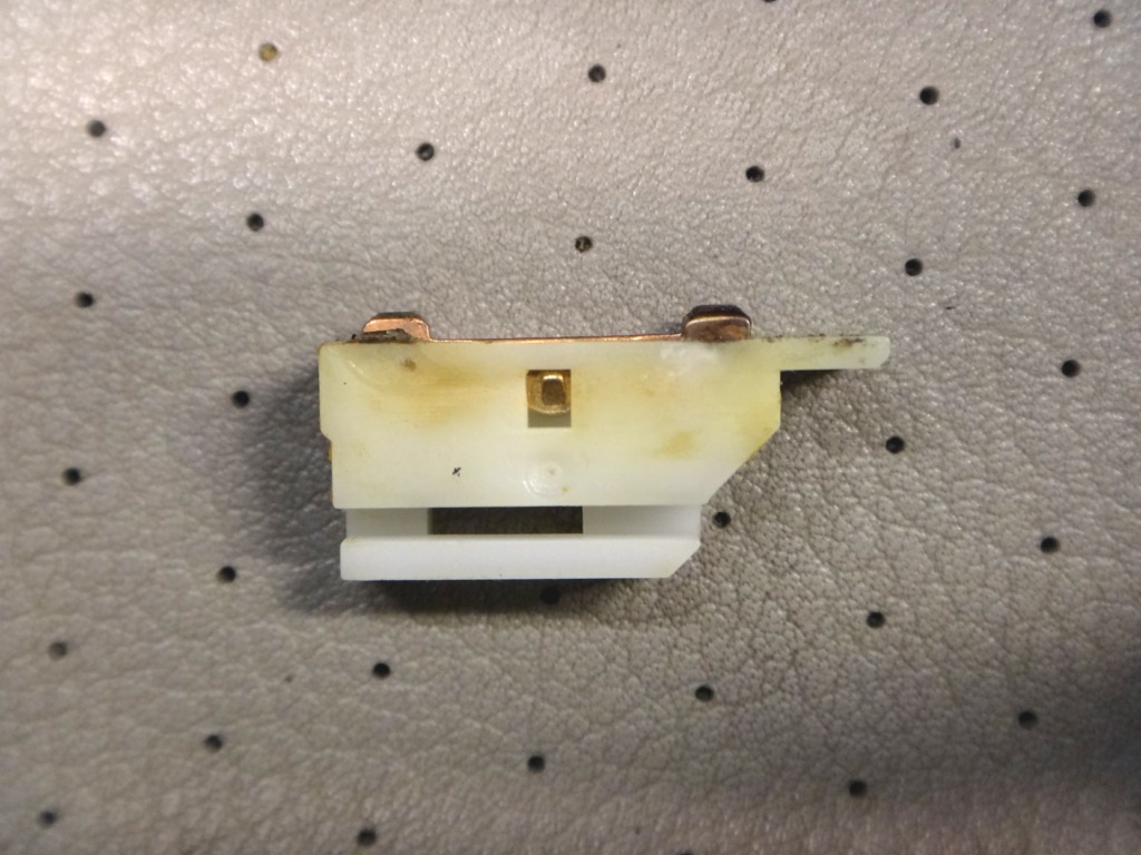

After popping the contacts out, I found the culprit. A bit of melted plastic was keeping the spring depressed.
A little work with a piece of sand paper got it all cleaned up. Fixed! Yay lights.

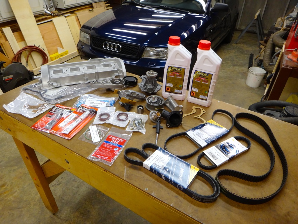

Got some parts delivered today...
Blauparts enhanced timing belt kit + new serpentine belt tensioner, Blauparts valve cover gasket kit, Febi cam chain tensioner, and a bead blasted valve cover.

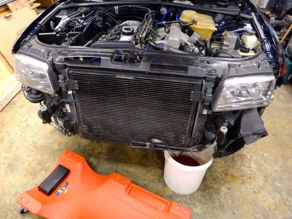

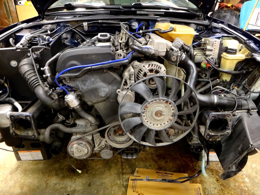

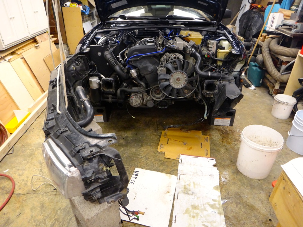

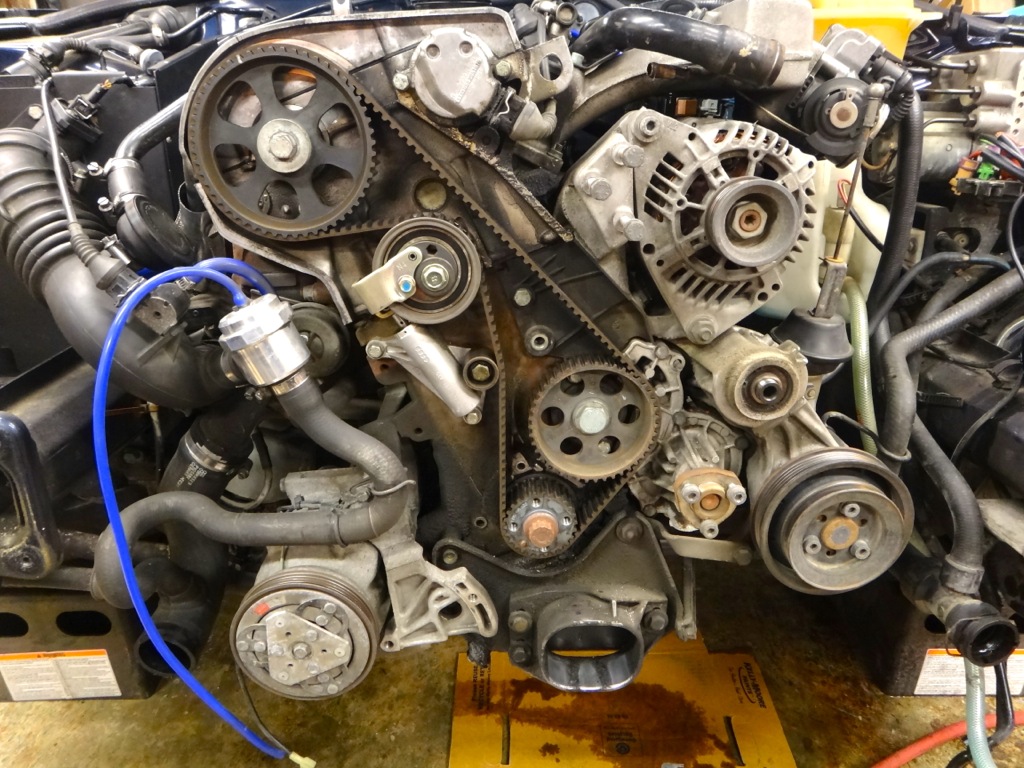

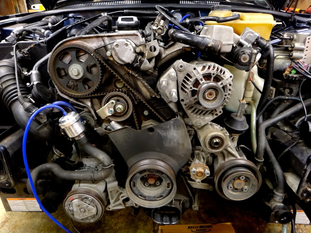

The tools I rented arrive tomorrow so I began the tear down tonight. Not so bad! I still had the most trouble getting the bumper off, it's no joke.
When I started to crank it to TDC it kept moving back...until I realized the car was still in gear. I hope I didn't bend anything...

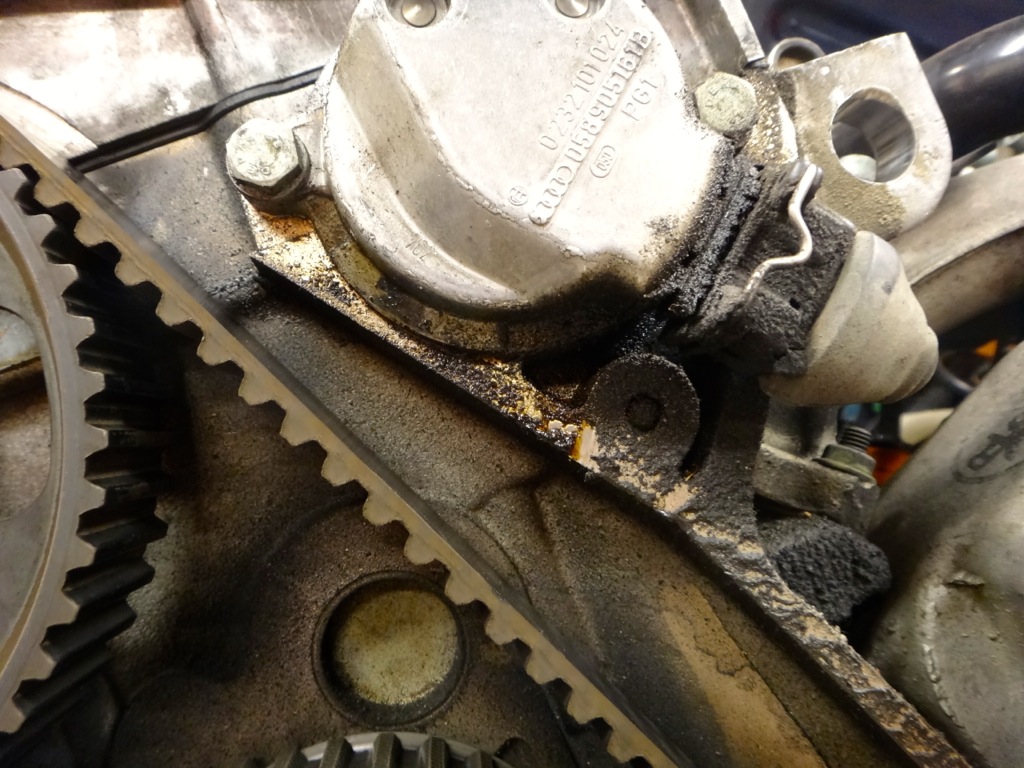

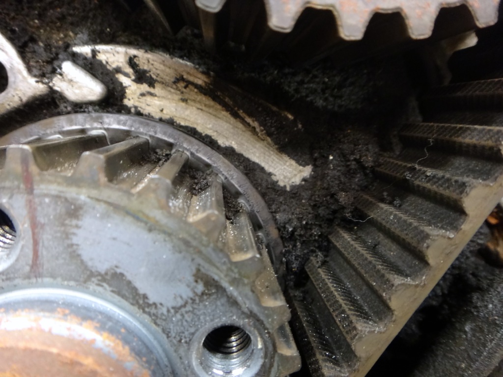

What looks like a leaky intake cam seal to me.

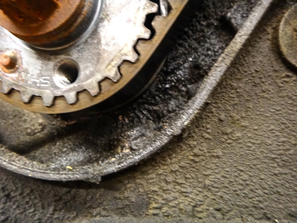

Some buildup around the crank pulley. Although a portion of that is from where I scraped the block.

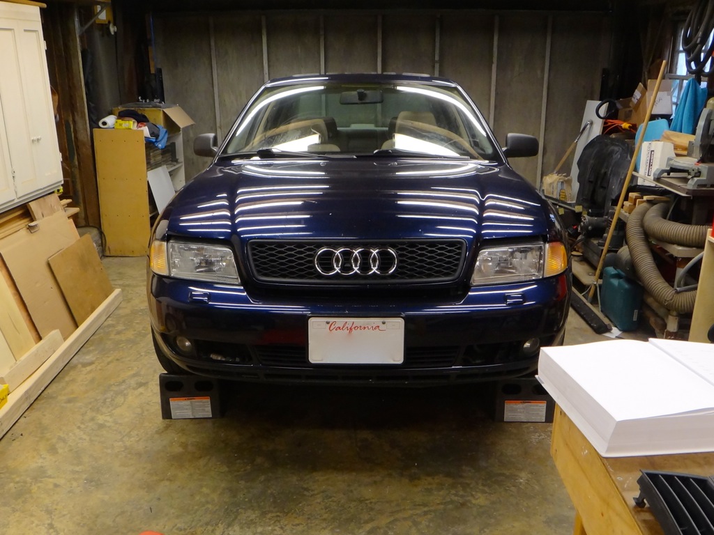

Ready for tomorrow!
