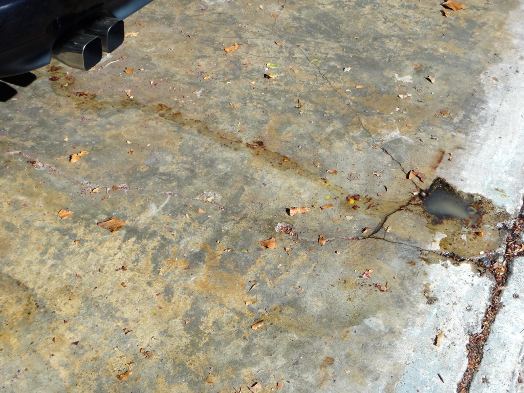

As I'm walking behind my car to get in it today I feel my foot slip..I look down and theres a little fluid on the ground. I thought it was left over from when I bled the brakes and went to wipe it up when I see a puddle and trail of liquid.

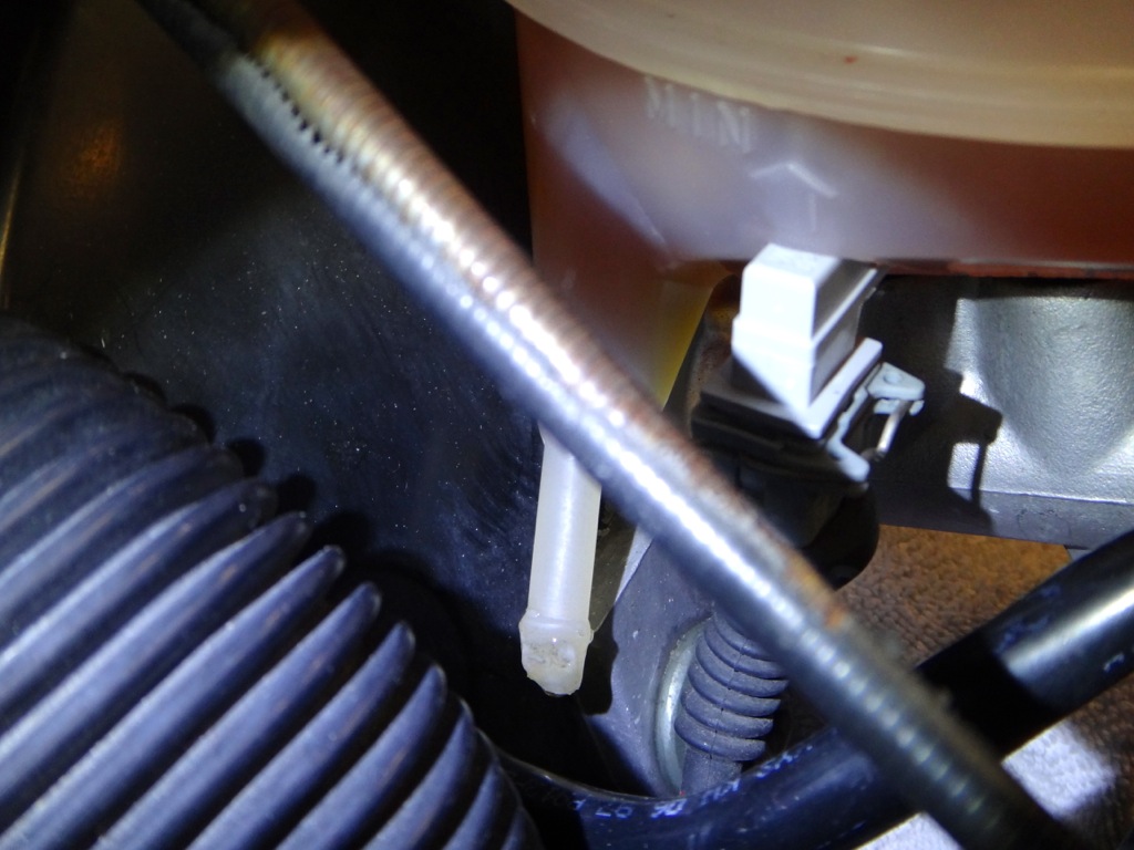

Brake fluid…lots of it. Pop the hood and the reservoir is nearly empty, just above the level of the master cylinder.
This was my fault. I made a stupid mistake when I got the new reservoir. New reservoirs come with the ports capped on the bottom and with the clutch line sealed. To open it up you're supposed to cut off the end of the plastic. My old reservoir had only one port for the clutch line. The new reservoir had two nipples with plastic ends to be cut off…I cut both off and immediately realized my error. Oh the curse words that left my mouth.
In what appears to be a foolish attempt to fix the reservoir, I found the piece I cut off and glued the **** out of it. It held fluid for the last week, but no longer.
Lessons learned:
Double check that the parts are the same. Even with the same part number these reservoirs were molded slightly differently.
Don't attempt to glue your brake fluid reservoir. Don't attempt to glue your brake fluid reservoir. Don't attempt to glue your brake fluid reservoir.
When working on such critical components as the brake system, check your work on a routine basis until you are positive all is well.
So I made a $100 mistake. At least I caught the mistake before I took the car out for a drive today, it could've been a lot worse.

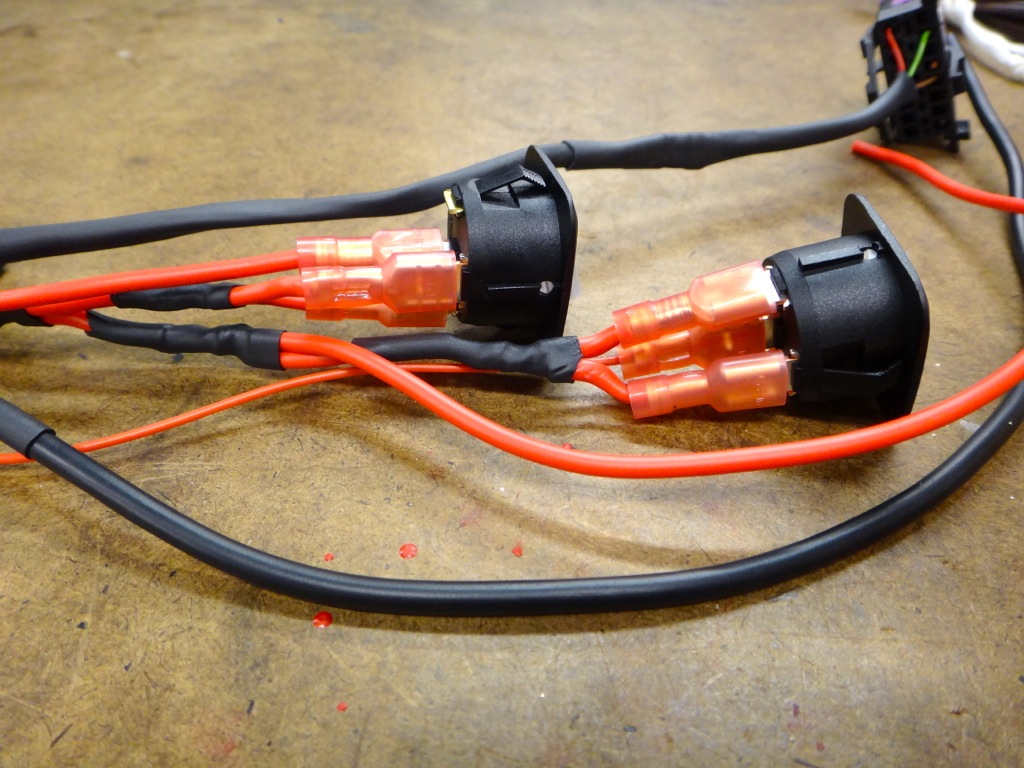

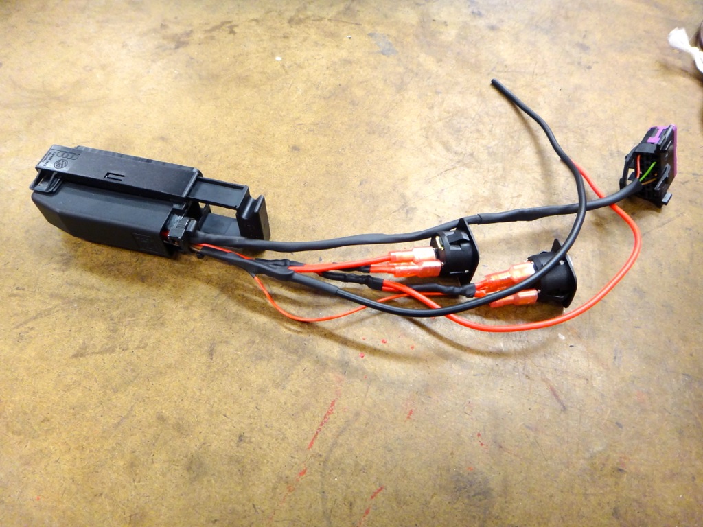

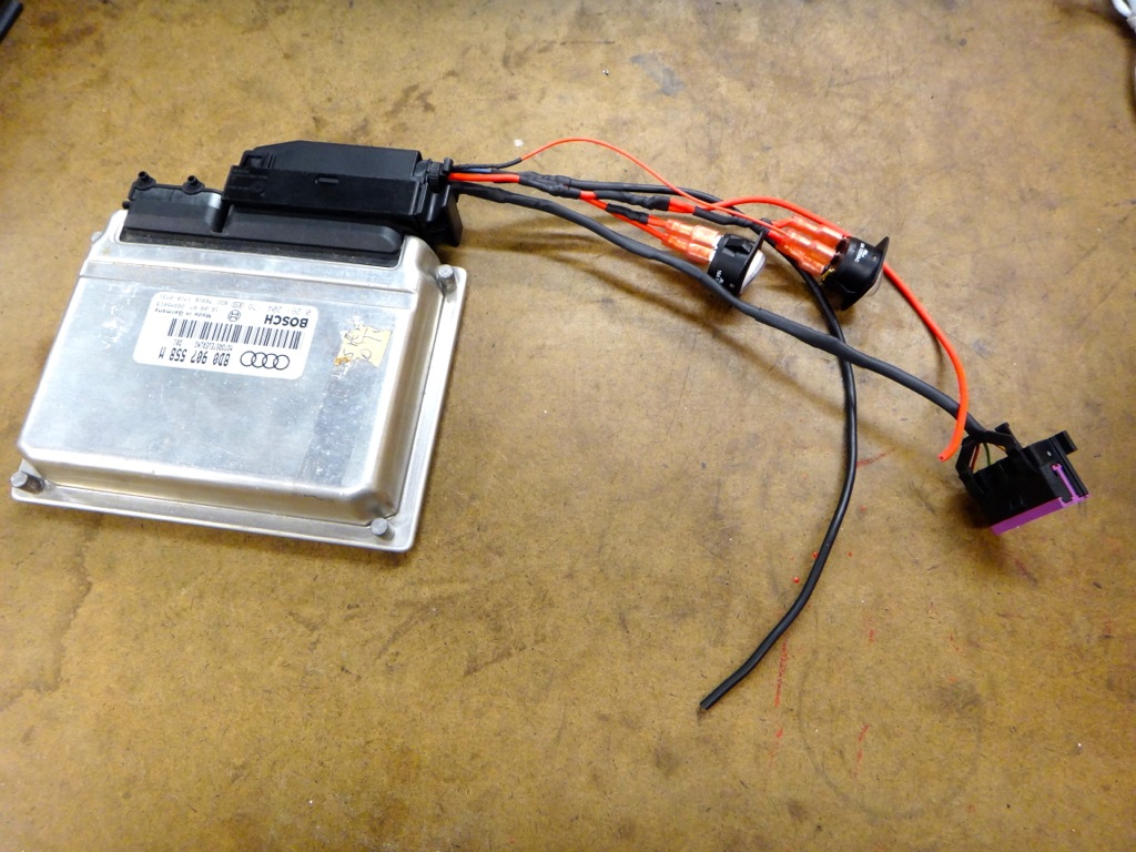

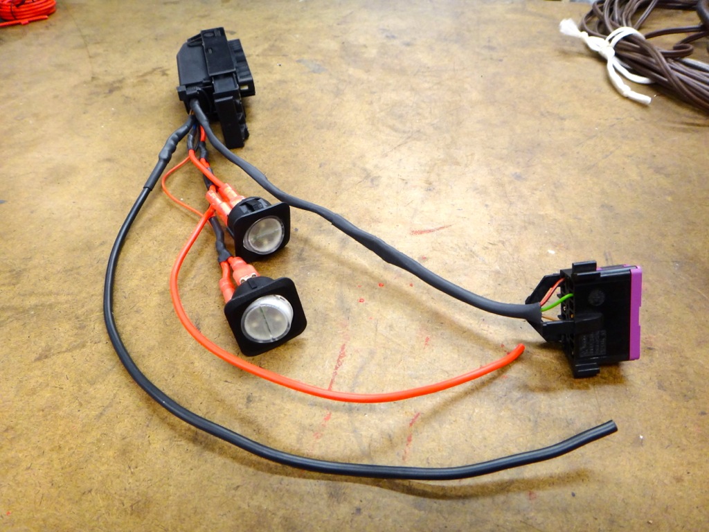

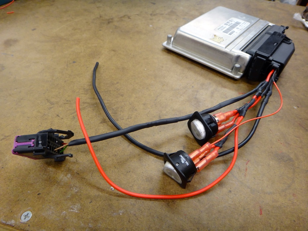

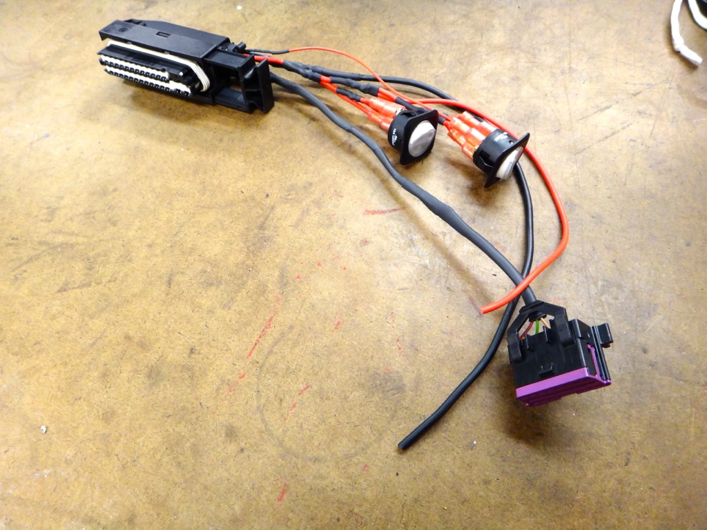

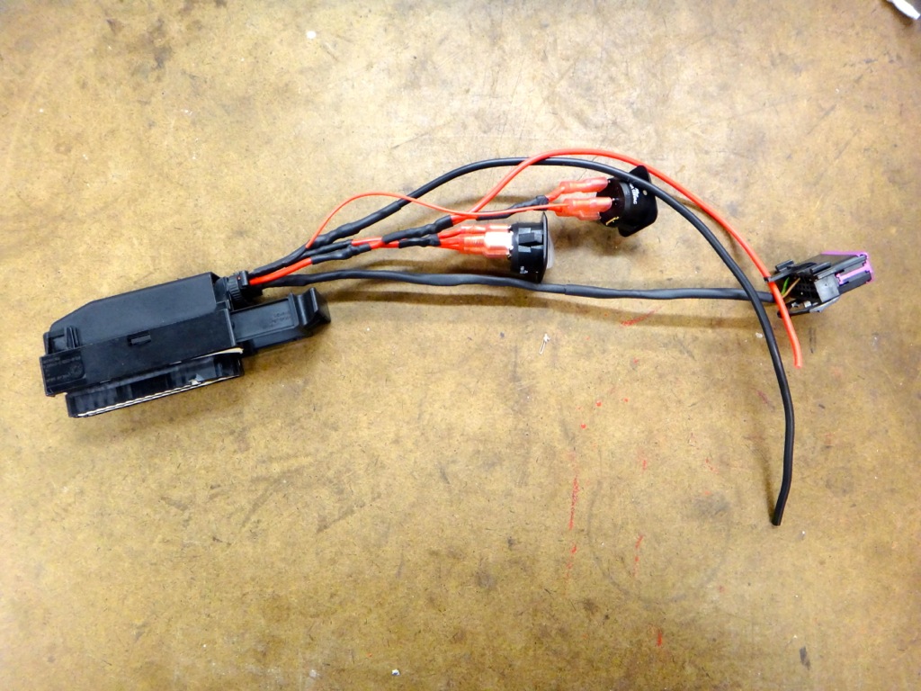

Tonight I worked on wiring up my bench testing/flashing harness. Not my prettiest work, but it should be sufficient. If I were to do this again I would build the harness inside a box for cleanliness.
One switch is to emulate the ignition switch and the other is to switch power on and off of pin 43. My understanding is that pin 43 must have 12v to flash 3.8.2 ECUs.

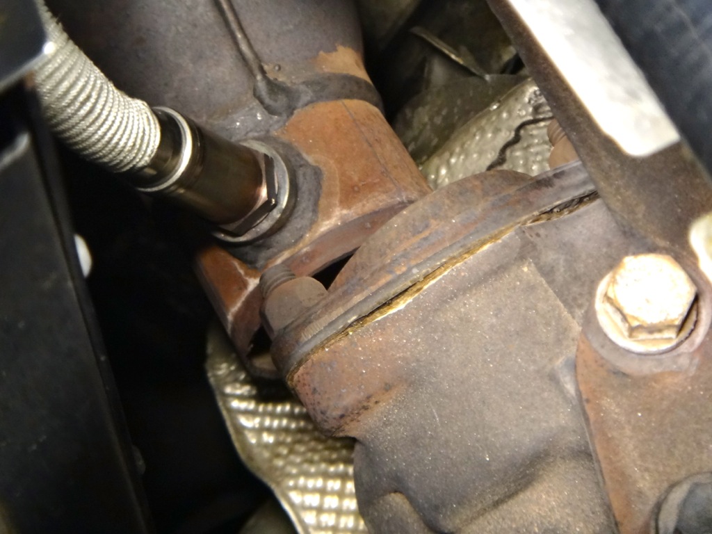

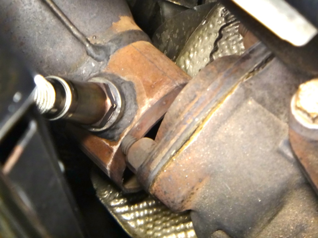

Bench testing rig works just dandy, got my ECU flashed with a new tune. I also re-plastidipped my last wheel, rewired the dash camera (again), got the proper bolt to tie down my full size spare, and retightened my pedal covers and shift ****.

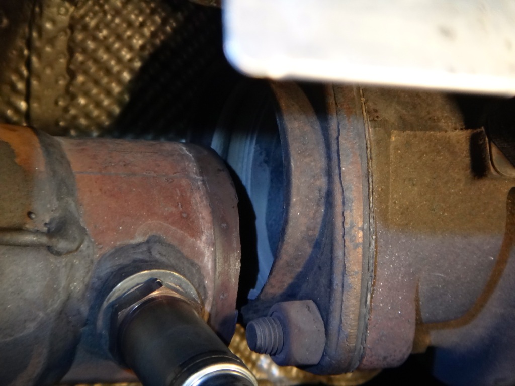

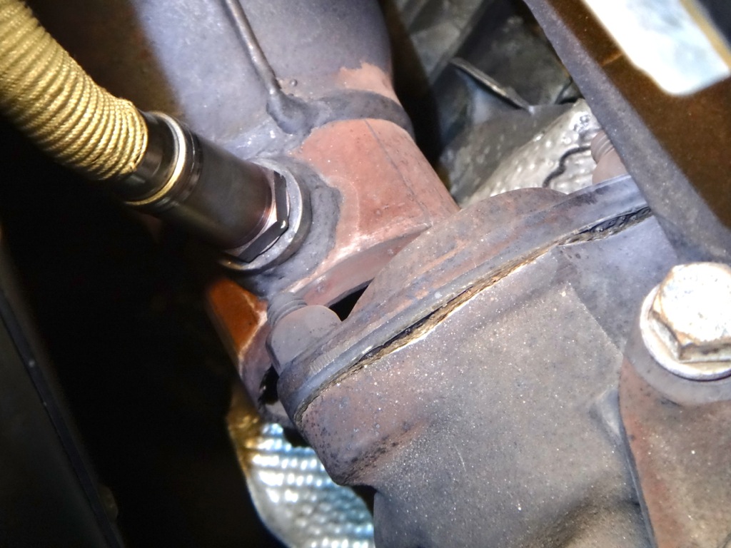

In other news, just as everything seems to be coming together something else breaks. That seems to be the name of the game, although this pattern seems to be increasing. I guess that is also to be expected as there are fewer and fewer stock parts on the car.
This time it was the cat-turbo flange that broke cleanly leaving me with an open turbo/exhaust. I was testing out the new tune on some backroads and heard a loud pop, pulled over to find this.
