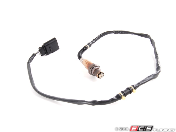

I do believe that link is wrong, since he will need a B5 oxygen sensor:
OEM / Performance Parts for Audi, BMW, Mercedes Benz, Mini, Porsche & Volkswagen - ECS Tuning
And I believe it would be this one specifically:
Audi B5 A4 Quattro 1.8T > Maintenance > Engine > Oxygen Sensor > ES#1563 Oxygen Sensor - 15160
Replacing the primary O2 sensor is definitely a good start - but if that doesn't fix it, the problem could potentially be a clogged catalytic converter.
