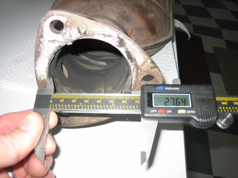

2. the exit of your turbo is 2.75 inches, so you will need to get a 3" (see picture)

Wow, thanks alot man, but are you sure the exit is 2.75? the stock exhaust is 2.25 so that would mean the cat has a larger input than output? Why would they have 2.5" test pipes then?

EDIT: The pic didn't show up before. I am very surpirsed, why are they selling 2.5" test pipes if the exit is 2.75... unless the test pipe has a larger inlet... What I like about the ebay tp is that the heatshield makes it look like a cat and that it comes with all bolts and both gaskets.
