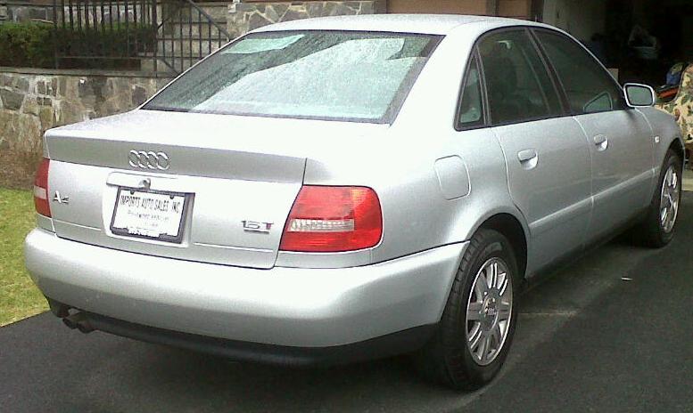

Hi All
I just purchased a 2001 A4 1.8T 5 speed, 94000 miles. Car looks to be in pretty good shape, drives well. One small ding in right front wheel well. A couple of questions...the oil pressure gauge does not move much above the low end number, the coolant guage also reads low, and the volt meter is around 14. Any comments, ideas..Would u recommend bringing to an audi dealer to run a full diagnostic for $128?? Thanks and looking forward to being a b5 owner.
