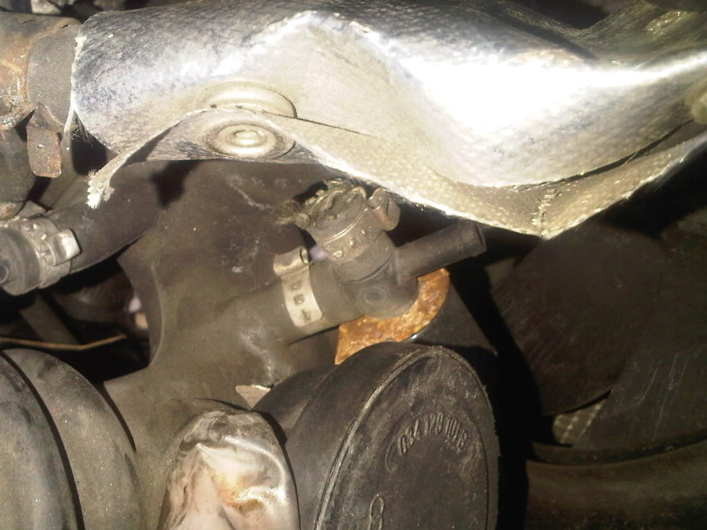

Well i checked the vac line from the wastegate and it seem that its ok. im still changing the lines but when i started to take things apart i saw a fitting that was missing hoses. this fitting is attached to the intake hose. Can somebody tell me where they go. here is a pic. You can see the left hose is broken and the right one is not even there. help please

Ok i think i figured out where these lines go. i looked for a vacuum diagram, could only find a b6 1.8t. dont know if they are the same but that pic i posted is the n75 and i think one line goes to the wastegate and the other goes the the turbo. please let me know if this is correct. who ever had this car b4 really did a number on the vacuum lines.
when i took it apart the turbo line was going straight into the wastegate and that intake hose was the way you see it in the picture. .
after switching the lines i drove the car around....now im hitting 7 psi. Is stock 10 psi?

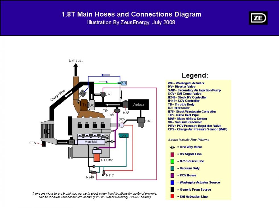

Might need to do a boost leak test. Ill find the vac diagrams, I saw them recently...
Old 02-21-2010, 09:08 PM
Msnickbroderick's Avatar
Actual WIZARD
Join Date: Jan 2010
Location: Dallas, Texas
Posts: 1,047
Here you go
