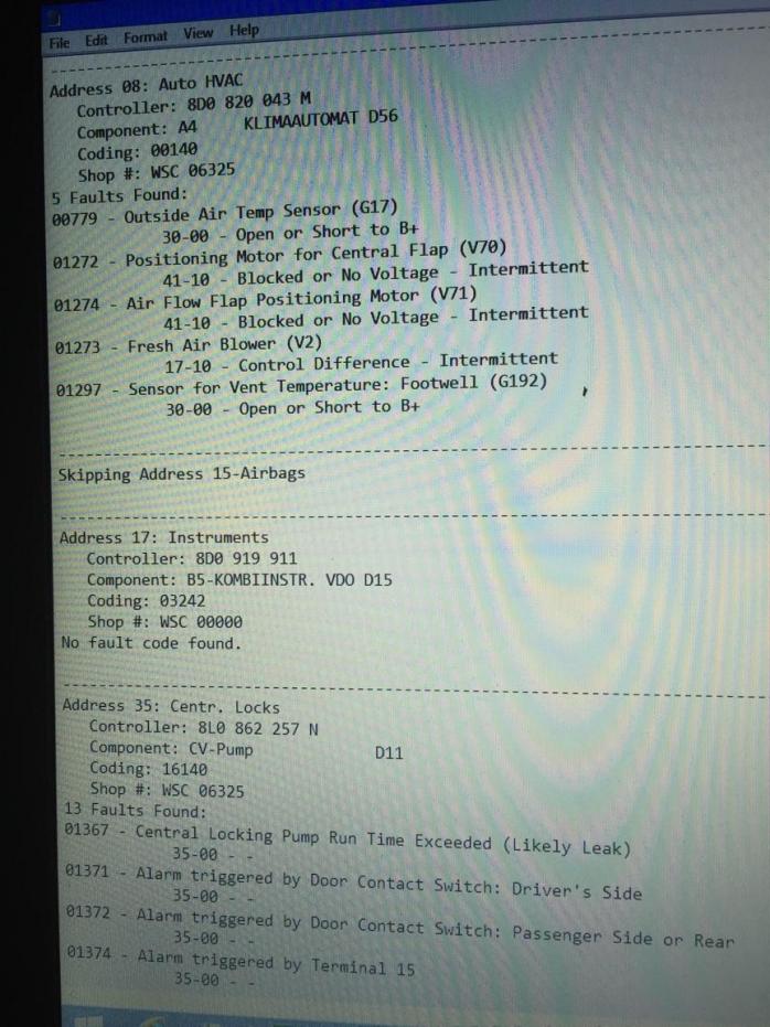

ok so i bought my audi a4 99 1.8 t Q back in mid febuary of this yea im the second owner of the car but any ways the first guy kept it dealer maintained
but recently it went in to limp mode gave me a couple codes so p0706 i replaced the neutral saftey switch didnt fix the problem so i took a look at the tcm and it was kinda soaked a lil bit so guess it fried somthing i changed that still no fix checked all the relays there all good i didnt have a vag com at the time so just the other day i hapen to run into sombody with one at my job so he scanned it for me so any help with this would be great so hers the screen shot for my vag com results
