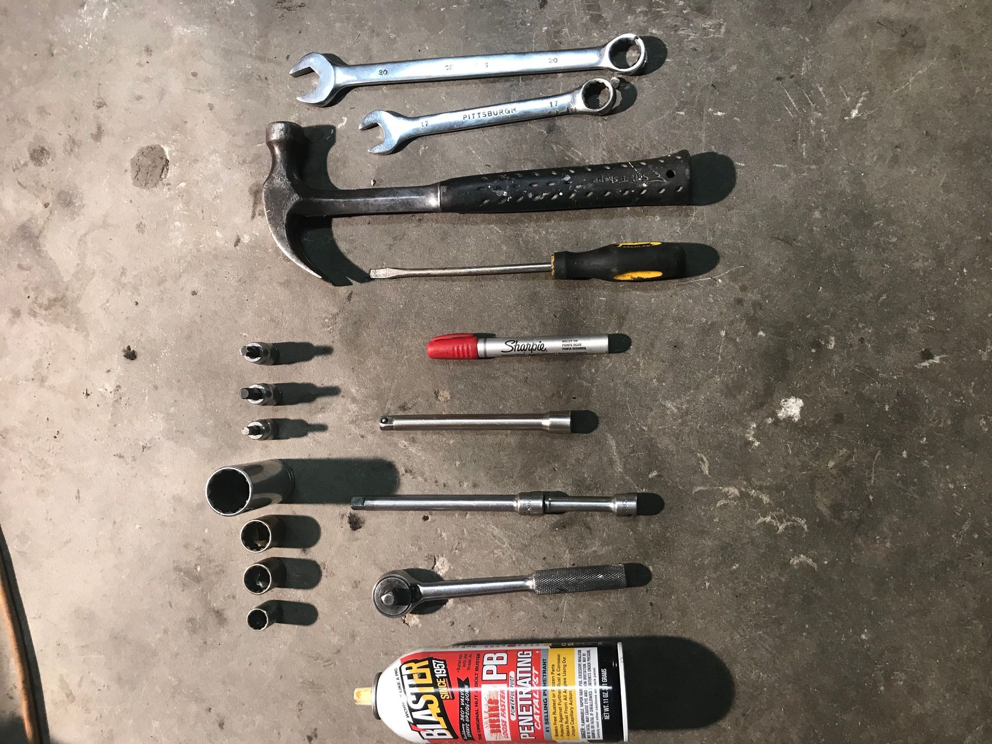

Tools:
1-1/16th Tall socket
19mm socket
17mm socket
13mm socket
6mm Hex
5/16th Hex
T-45 Torx
20mm Wrench (optional)
17mm Wrench
Flat Screwdriver (to pry)
Extensions (far reach)
Big Wrench (also optional, to hold exhaust pipes apart)
PB Blaster
Hammer
Grinder (not pictured)
Steel block
Surgeon steady hands (maybe)
https://cimg4.ibsrv.net/gimg/www.aud...c27ff336ec.jpg

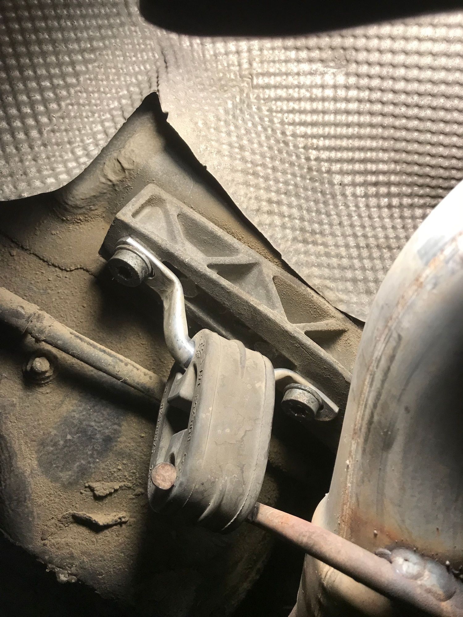

Placed a jack on the exhaust muffler on the rear to hold it up as I unmounted the pipes from the rear of the differential which were 2 13mm.
https://cimg0.ibsrv.net/gimg/www.aud...7288253e3c.jpg
Then worked my way to the second mount under the mid section of the car which was a T-45 Torx

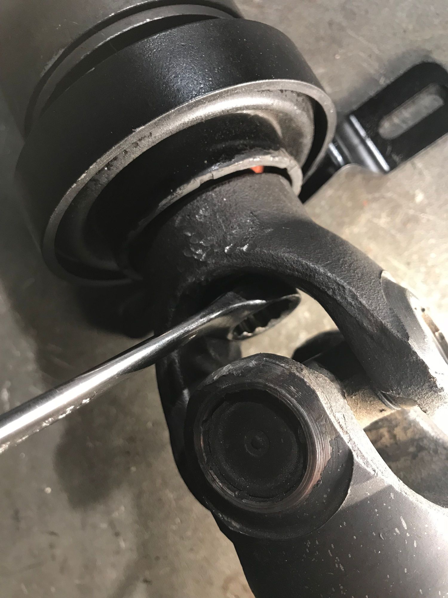

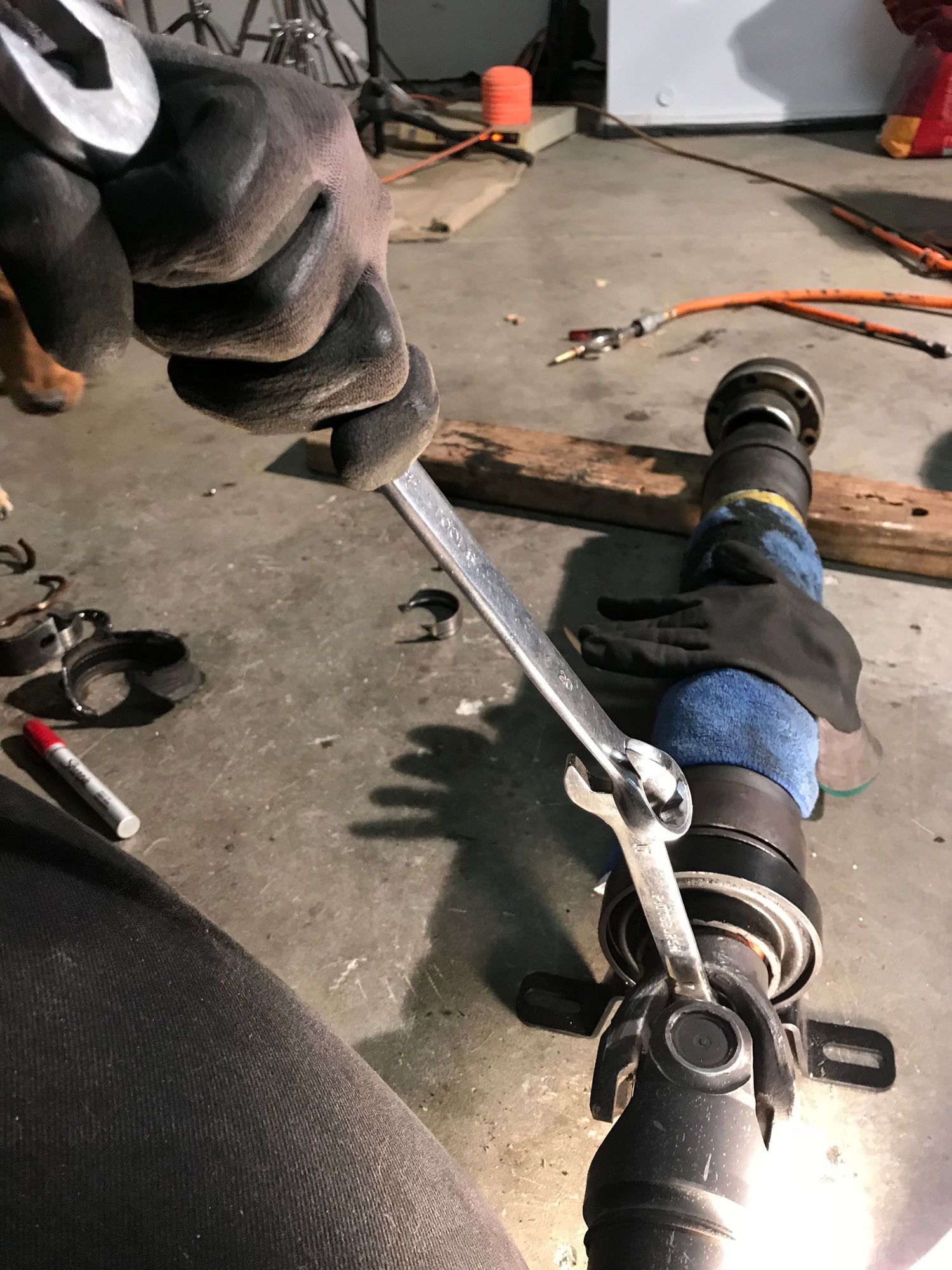

Now inspect the driveshaft, in between the U-joints you'll see a Bolt head, its a 17mm, don't try sticking a socket in there, even using a swivel and extension through the center hole that holds the UJs won't get that bolt and washer out. You have to use a 17mm wrench with some adjustments to the wrench, which is filing or grinding down the sides of the wrench to be able to get 1/4 of a turn, eventually getting it out. *note: don't grind too thin to where the wrench will break.
https://cimg1.ibsrv.net/gimg/www.aud...62382ab3b6.jpg
https://cimg3.ibsrv.net/gimg/www.aud...ce3a498a67.jpg
Now that 17mm was tight so I interlocked the 17mm with a 20mm wrench to get a better grasp of the bolt and also used a pry bar through the UJ to hold the shaft from turning and finally broke it loose. Now if you want to try the Wedge technique from here, you're more than welcome, just loosen the bolt half way, insert the wedge between the bolt and UJ, and hammer away, but as I said, it didn't work for me. I worked for 2 days using that wedge and it never worked.

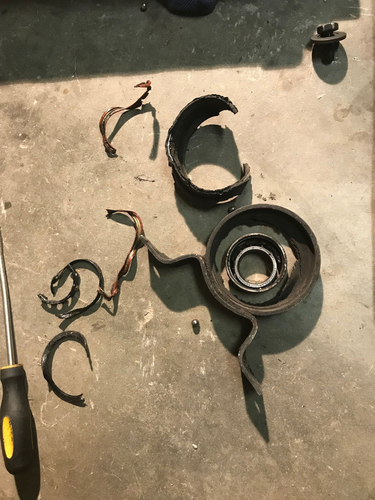

Now here is where things took a turn, I thought what if I cut the bearing support all the way through.....yeah sounds like it might be a stupid idea, but at this point it was either buy a new driveshaft or go all out and get this to work. So the actual (support frame) rubber was so old I was able to tear it and slip the frame of the bearing support out of the way still on the driveshaft. Then I began to cut through the rubber hitting the bearing, removed the bearing casing then the ball bearings came out. I stopped there to pull off the bearing covers, now all that was left was the ring that the ball bearings ride on (attached to the shaft)
https://cimg9.ibsrv.net/gimg/www.aud...c0960570c8.jpg
(The bearing was already off in the above picture, I just decided to start taking pictures in the reverse order as everything was already done but the gap between the shafts should be right against the bearing.)

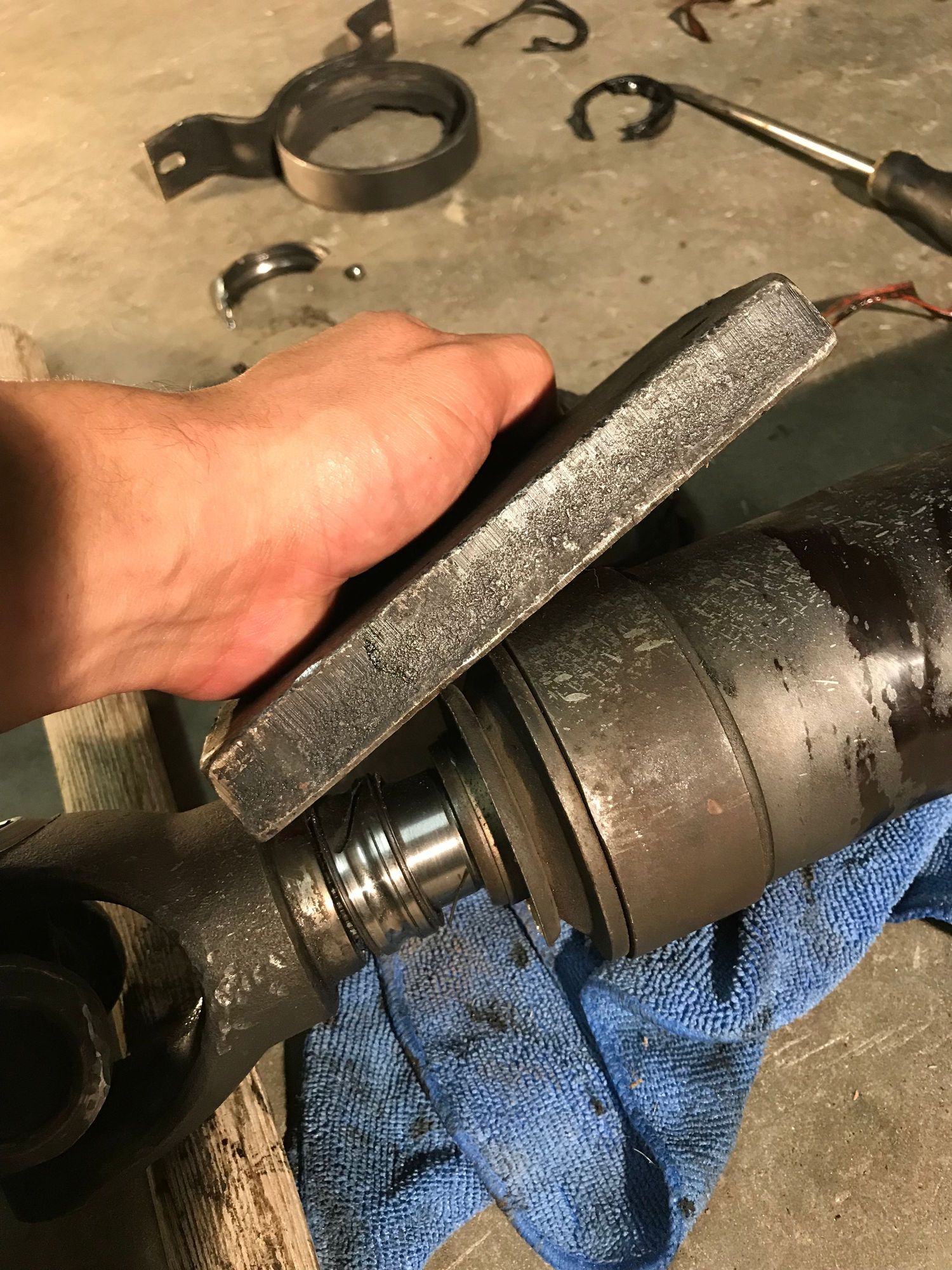

So with the bearing out of the way now, we have more room to work with. so this is where you grab your steel (rectangular) piece and place in along the inner lip of the UJ.
https://cimg7.ibsrv.net/gimg/www.aud...55eadc0f92.jpg
Now this is where hammer time comes in. I decided to strike against the more solid shaft because other other half is carbon fiber and I didn't want to knock or damage the carbon fiber shaft, not only that but both UJ's are connected to the solid shaft. I laid a cloth over the carbon fiber shaft and rested the steel against the cloth so the impacts against the opposing shaft wouldn't damage the carbon fiber shaft. (above picture, again no cloth shown because I was putting it together)
NOTE** Give the shaft about 2-3 hard strikes and rotate the shaft and do the same on the other side repeating until you begin seeing the teeth or splines of the shaft.

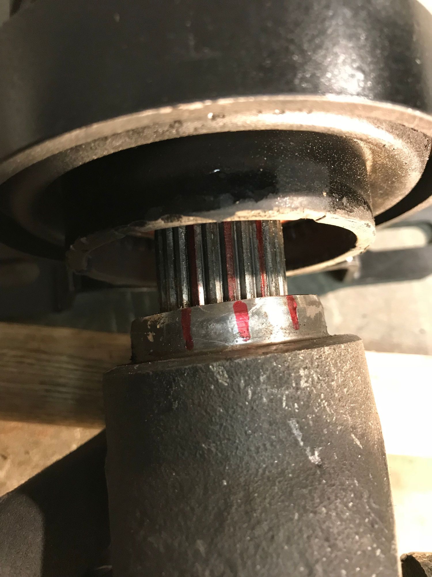

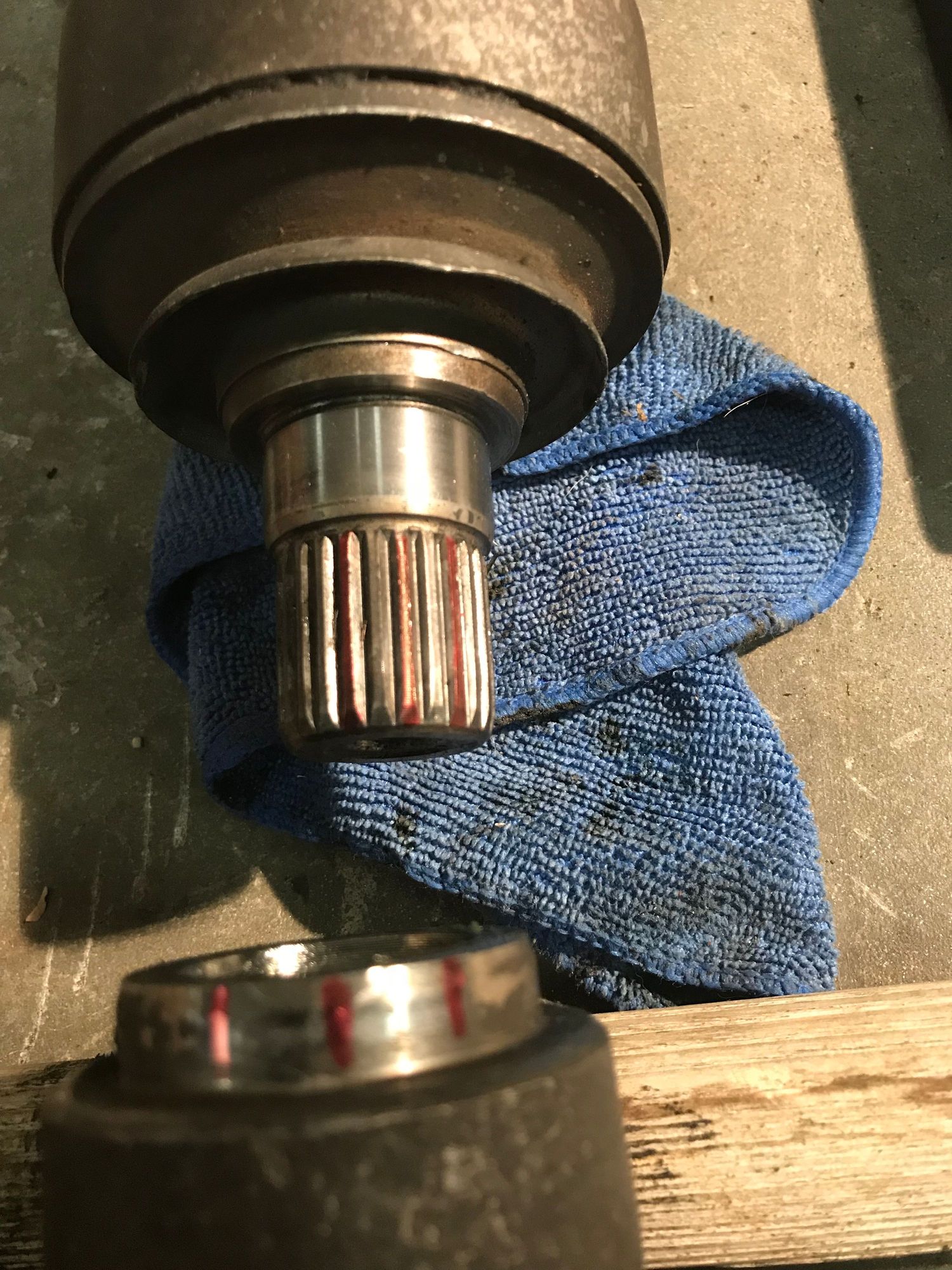

With enough room in between the shafts mark 1 or as I did, 3 teeth matching to the opposing shaft with a visible mark because this is the set balance on the driveshaft, if you noticed the solid shaft, it has balancers welded onto it, and not marking and matching those teeth will get you one hell of a vibrating ride because of the balance throw off.
https://cimg0.ibsrv.net/gimg/www.aud...0413f7c7d2.jpg
So once you've carefully and accurately marked 1 or 3 teeth, proceed with laying the cloth over the CF shaft and continue striking the shafts apart on both sides until the finally separate.

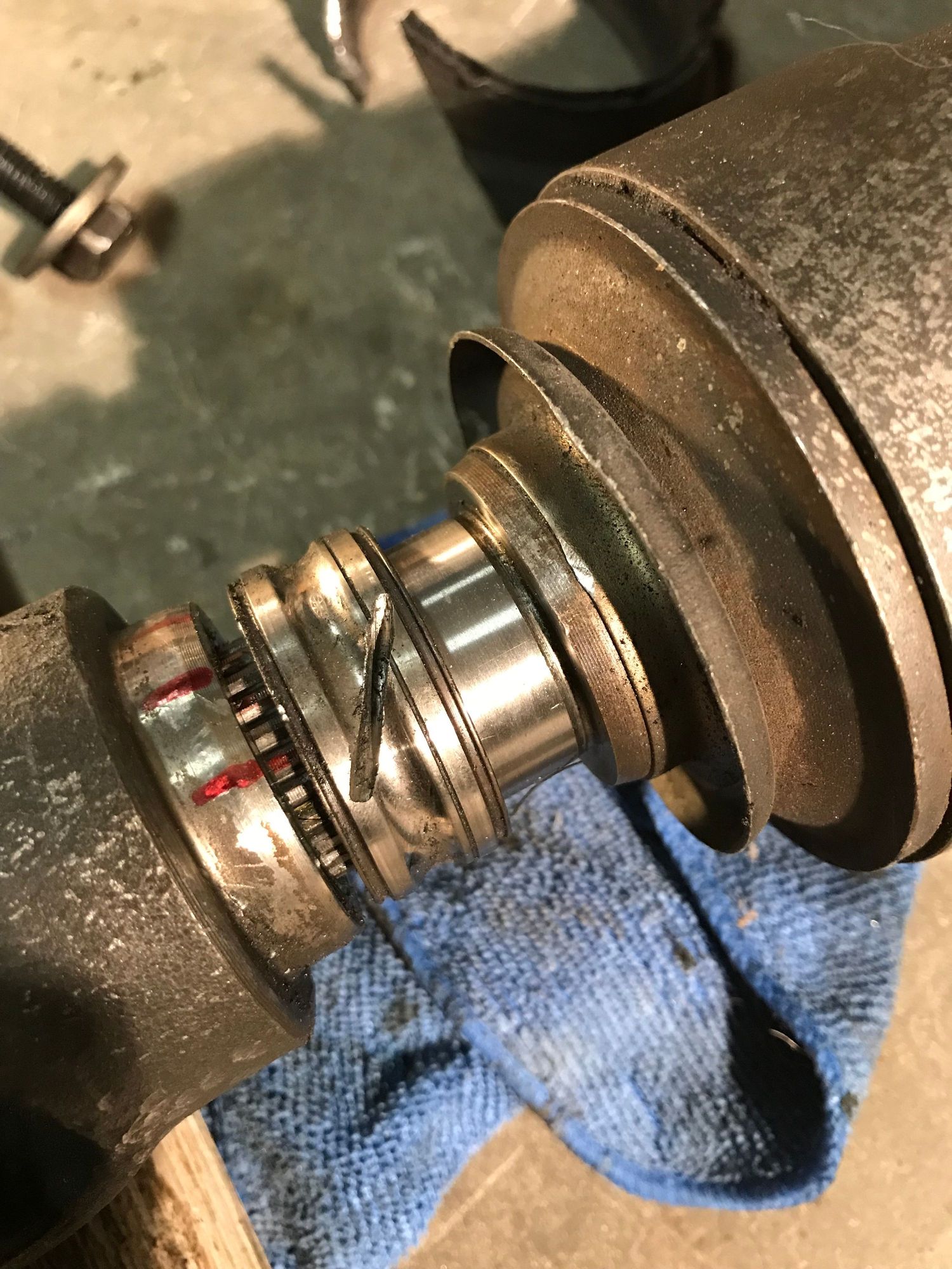

Now with the inner ring of the bearing still attached to the shaft, use a flat screwdriver and pry it out, you might have to hammer the screwdriver in to give you some pry space. Luckily I made that pre-cut and was able to use that to hammer the ring off the shaft. Clean the shaft surface and put on the new bearing, the rubber flange faces the rear (solid shaft) in case you forgot.
This is where the 1 1/16th long socket comes in, it fits perfectly around the diameter of the shaft and sits perfectly on the inner ring of the bearing without any interference. Tap it lightly until it sits all the way down. Now from this point on its just putting it back together. So bearing in place, match up your marks and connect the shafts back together. Hammer the UJ lightly to get the shafts to connect close enough to get the washer and 17mm bolt started. From that point on, tie it down, the shafts will close as you tie the bolt down. Now put the shaft back under the car and do the reverse sequence, insert one bolt on the driveshaft to the tail of the transmission, insert the bolts to the support frame, and finally one bolt to the rear differential. Once it's all in place, tie down the driveshaft completely from end to end. The bearing needs to be tied down last because you have to adjust it as straight as possible to reduce vibration.
