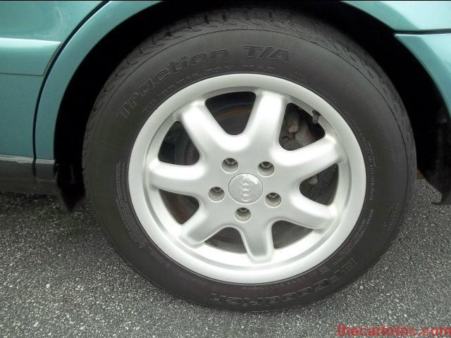

One of them, a 99.5, lacks the power seats and the typical B5 wheels. I suppose the ones on this car are a lesser wheel, but I'm not sure. I'll attempt to include a pic below.
QUESTION: How did the option packaging work on these cars? The wheels are fine, and so is the manual seat (assuming it DOES still have a [manual] ability to raise/lower the seat, yes??). But did the performance equipment of the cars also vary? If my car is less equipped (wheels and seats), might that mean it also has inferior suspension or engine characteristics? Or was the performance stuff standard across the whole line?

It has manual seats because power seats were never offered with the 1.8t engine, only with the v6. Those wheels are regular old wheels, standard equipment for that year. From that, I'm guessing it isn't a sport package.

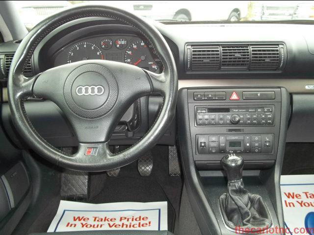

Hmmm. The car I'm leaning toward has the sunroof, has what i think is probably the sport wheel (?, see pic below), but doesn't have the Sport wheels (has the wheels shown in Post#1). So probably not a Sport Package. It's out of state, I haven't driven it yet.

The wheel I think is a Sport Wheel...?
yup that's a sport wheel. to see if the suspension is sport, check the springs and shocks. The springs will be black with a violet and green dot on them, and the shocks will be red. even if you don't get a sport model, youd only have to change out suspension and sway bars. not a big deal and you'd probably upgrade those things eventually anyways. as for the wheel, youll change those too
