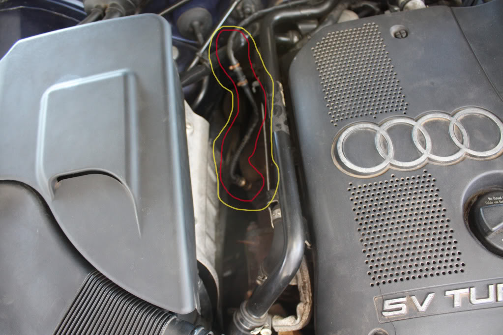

Im pretty sure it's the 5 wire. I took a picture of the area i thought it was in please let me know if i'm right.

your best option for the 4 or 5 wire question is ask the dealer, just be like hey i have a bad upstream o2 sensor and i need to know which one to get cuz there is a 4 and 5 wire option and i wanna get the right sensor... they should help u out there
I think the O2 sensor could be 4-wire - at least that's what all the replacements are listed as being (even the direct fit ones). Just buy a direct fit one and you'll be fine. I get mine from www.rockauto.com though you can go to Autozone/Advance/whatever if you need it soon and don't mind paying more.
It varies. If it can be easily gotten out, it's an easy job. The best thing to do to get a stuck one out is to hit it with Kroil (which is much better than Liquid Wrench and PB Blaster, which are in turn better than WD40), wait 10 minutes, repeat this cycle 2-3 times if it looks bad, cut the wires near the sensor (unplug it first though), and use a 22mm regular deep socket to get it out. For the replacement, use a specialized O2 sensor socket with a slit down one side to put it in. Use anti-seize compound on the threads.

the 01 is a wideband sensor which is 5-wire.
if you take the airbox and everything out, all you need is an O2 sensor wrench ($7 at autozone) and the socket wrench and extension to go with it. spray some WD40 on it an hour or two beforehand.

Ahhh, I was looking up for my 2000. That'll do it. Ghost's simpler method might work for getting it out, but I would still use something better than WD40, like Kroil*.

Thanks guys for all the help and info. Give you guys a update. I found one in my local area for $155 OEM. I dont mind spending a little more since I wont wait time to get it in the mail. It is the 5 wire and i'm gonna go pick it up from autozone right now woot woot
So I guess I have a split year 01 so the precat was actually a 5 wire. It was weird because all the websites suggested the 4 wire even autozone did as well. Just in case any of you wanted to know. Was really easy to install. check engine went away too
