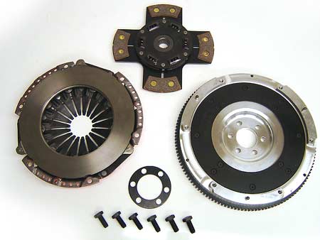

This ATP kit?
That is just a standard 12 lbs Billet Aluminum Aasco flywheel that nearly everyone in this world sells. Aasco even makes a 11 lbs version. So you shouldn't have any problems using it with another clutch kit and you can even buy a replacement surface ring for that flywheel.
here is the 12 lbs Aasco flywheel offered by AWE, same flywheel.

What type of clutch were you trying to put in? Sounds like they were trying to install a sprung hub facing toward the flywheel with a set of flywheel bolts that have a stock height head. You cant NOT do that. To install it that direction you need to use bolts that have a very short head so they sit low enough to allow the disk to spin without catching the bolts. Believe me I see this issue come up when people use stock flywheel bolts on a lwfw and then face the taller side of the sprun hub toward the flywheel.
Pretty much all of the clutch kits are produced to work with nearly all of the flywheels. Only flywheel that didn't work with most of the clutch kit was the old Fidenza flywheel which did not have a dished center, so it put the flywheel bolts up near the surface of the flywheel and could really only be used with a unsprung disk.
If you have the same flywheel as you see in the picture I posted earlier, then yes you can use a SB or Spec clutch. If you need one feel free to contact me or order one from our site.
