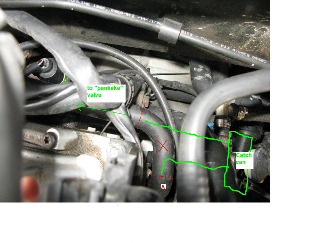

Since I want to put the can under the coolant reservoir, I will need to cut the hard line where it begins to turn down, back by the firewall (see pic). I would cut where the dashed red lines are and plumb the can in series (green lines).
But I still have a couple questions.
1) How is the "A" end of the pipe connected and how can I remove it?
2) What are the disadvantages of this setup?
Responses are appreciated. Dont be shy
a catch can doesnt need any specific pressure level to work, its just a can that collects anything heavier then air that passes thru it. however i have read that it is slightly better to have a negative pressure atmosphere inside the block, rather then a completely open can.
this would help in the evaporation of water and volatile chemicals as well as prevent seals from leaking. if you just blocked off the vent hole completely, or it somehow got to be positive pressure inside the engine, it could push oil past seals and stuff like that. as long as the can is at least vented it shouldnt be much of a problem either way you want to do it.
and i dont really see what pics you are refering to here
