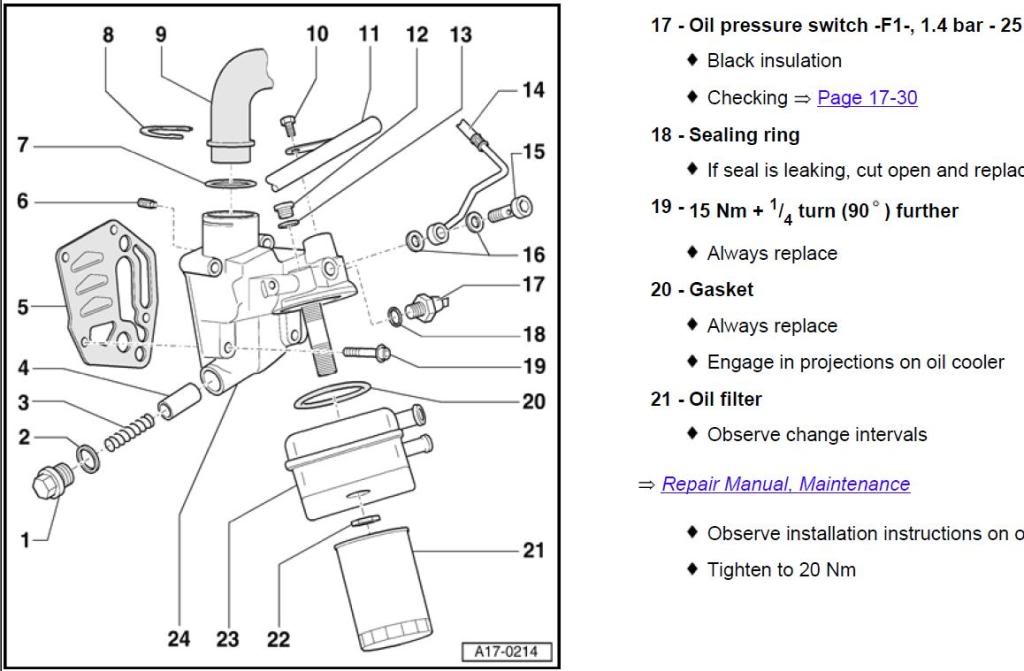

the oil light usually indicates low oil pressure not level. if oil level is normal (and since your a timing belt 1.8t driver) it may be a clogged oil pick up tube. but like you said it can also be a ad oil level sensor or bad oil pressure sensor. i would put some seafoam in the crankcase and let it run for another 500 or so miles and change the oil. during which time i would see if the light comes back on the oil change is cheaper than the sensors they usually need to be pulled with the oil drained so id start there.

Any idea on where the oil pressure and oil level sensors are in case I have to replace them?

the mechanical oil pumps rarely fail. you have an internal oil pump (no IM shaft) so it is driven off a gear on the crank i believe, not from the timing belt. if you are good about chaning the oil regularly with synthetic, its probably a dead oil pressure sender, which is located around the oil cooler (which the oil filter screws onto). or it could possibly be some sludge buildup. it still happens even when using the right oil and everything. heres how to test/replace the switch.

Thanks for the diagram and the how to on checking the oil pressure switch Ghost6303. However, I don't have a VAG-COM. What's involved with replacing the oil sender, or would you try the deisel engine flush first?

you can substitute that VAG tool with a multimeter to check it. just put it on OHMs and where they say to watch the light to turn on or off, watch to see if you get continuity or not. (zero or low ohms = light turns on;good continuity // high or infinite ohm reading = light turns off; no continuity)
if the seafoam didnt do much, i would try replacing the sensor. i wouldnt imagine it would be more then 20-40 bucks. all you should need is a wrench.

I'm still not clear on what's involved with the oil sender (how it works, why it needs to get replaced,...) and whether the deisel or ATF treatment would clean the oil sender out and fix it, or if it would still need to be replaced regardless.
