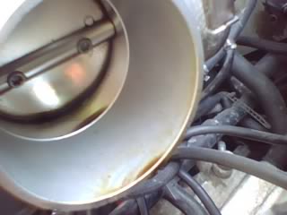

Ok, there's a little bit of oil in my throttle body and it even looks like there is some burned onto the edge of the valve within it.
Here's what it looks like, do you guys think it's something to be worried about?

If the oil is at your TB then yes I would be worried. You might want to do a compression test just to rule out too much blow by caused by bad piston rings.

compression is a bit low on cylinders #2 and #3. Those numbers are puts those cylinders down below 8.5:1.

Most likely just blow by causing the oil to be pushed out of the crank case breather which ends up in the intake system and why you see it at the throttle body. You need to check the IC pipes/hoses just after the turbo to see how much oil is being pushed out of the crank case.
I had some rings go back on my stock motor, it was pushing so much oil out that my TB hose was sweating oil.

So a catch can would only treat the symptoms and not the cause of this, right? I'll probably need new piston rings?
Old Jul 27, 2009 | 01:52 PM
  #20
Mike-2ptzero's Avatar
Joined: Apr 2008
Posts: 3,274
From: Phoenix, Arizona area
Yeah rings are the only thing that are going to fix the issue.
