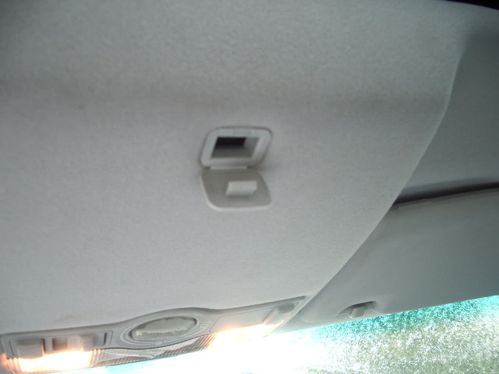

If you pop the end cap off the driver's side of the dashboard, there should be a long z-shaped allen key clipped onto the cap next to the fuse remover tool. Between the sunroof and the sunroof switch, there's a little square-ish cap that pops open. Open the cap, insert the allen crank, and turn it to open/close the sunroof.
Old Feb 11, 2009 | 08:52 PM
CCA4's Avatar
Posts: 7,588
From: NW PA
Stuck to the inside of the fuse box cover (open the driver's side door and pop off the B shaped plastic thing) there will be a bent piece of metal that vaguely resembles an alan wrench. Thats actually the crank that you use to manually open/close the sunroof. To do that, pop open the little plastic door just to the rear of the sunroof switch
Like this.

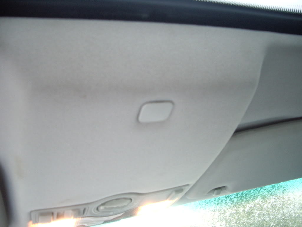

Crank away to open/close the sunroof.
The sunroof motor is a common problem on our cars, you can buy replacements online and I even believe there is a DIY to fix yours w/o replacing it. try audidiy, there should be one there.

my sunroof open button is just a small little rectangle there is no little opening behind it. and when i take the button out there is nowhere to insert the tool....

Huh. Mine is a '97 so i figured it'd have the same set up you do but clearly i was wrong.... Sorry about that man. I dunno what to tell ya
