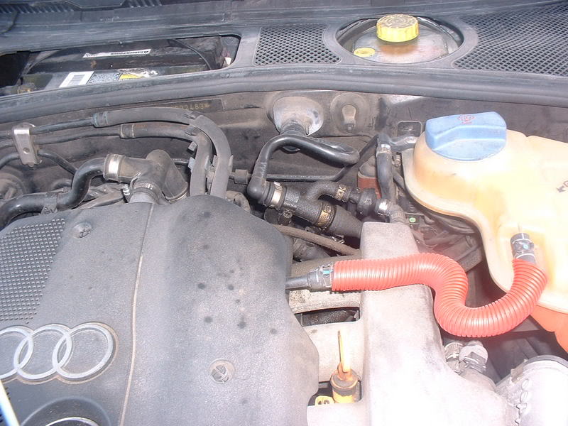

check right above the red hose, on the bigger part of the hose see how its connected. I'll bet its loose so when you push down on the gas, it disconnects and loses a ton of air. I had to replace that hose, is it a noticable loud hissing noise?

Ok guys, just got back from Autozone. The guy who scanned it got an all OK. While in gear the vacuum is almost perfect- about 21-22. And yes, A4speed , I do have a loud hissing noise which I noticed once I removed the valve cover.

buy that new connecting hose, replace it, and see what your psi goes up to then. that hissing noise is making you lose a ton of performance. just to check to make sure its that hose, tie some wire on each side of the connector to keep it together so when you drive your car, it can connect the hose long enough to see if thats what the issue is.
