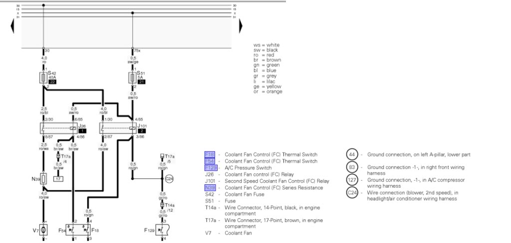

The fuse to my electrical cooling fan keeps popping (the big orange 40 amp one that's located in the relay carrier under/behind the steering wheel). The new fuse I put in lasted an hour or two then popped just like the old one. I don't want to spend another $2.50 until I figure out the source of the problem.
Anyone know what is likely causing more than 40 amps to go to this fuse?

you mean your secondary (electrical) fan? or did you replace your crank-driven mechanical fan with an aftermarket electric one?
the more load there is on the fan, the more current it has to pull. if it was spinning freely (in a vacuum with zero air to push) it wouldnt require very much power at all. if it were rubbing against something, or trying to push air backwards (into the direction you are moving) that would make it work harder and pull more juice. other then the obvious short in the wire somewhere, i would look to see if its spinning freely.
also does the fuse pop when the fan first kicks on or after it has been on for a while? it should be a slow-blow fuse, meaning it can handle short bursts above 40A without blowing. like when the fan first kicks on.

If its running an hour or two till popping the fuse, I would call it a fan going bad. Its pulling close to the 40amps just to spin, which is actually way more than it should, heating up the fuse until it blows. As ghost said, look for something in the way and that its spinning freely.. Also make sure your radiator fins are clear and air is able to flow freely through them. If they are plugged, the fan works harder.
